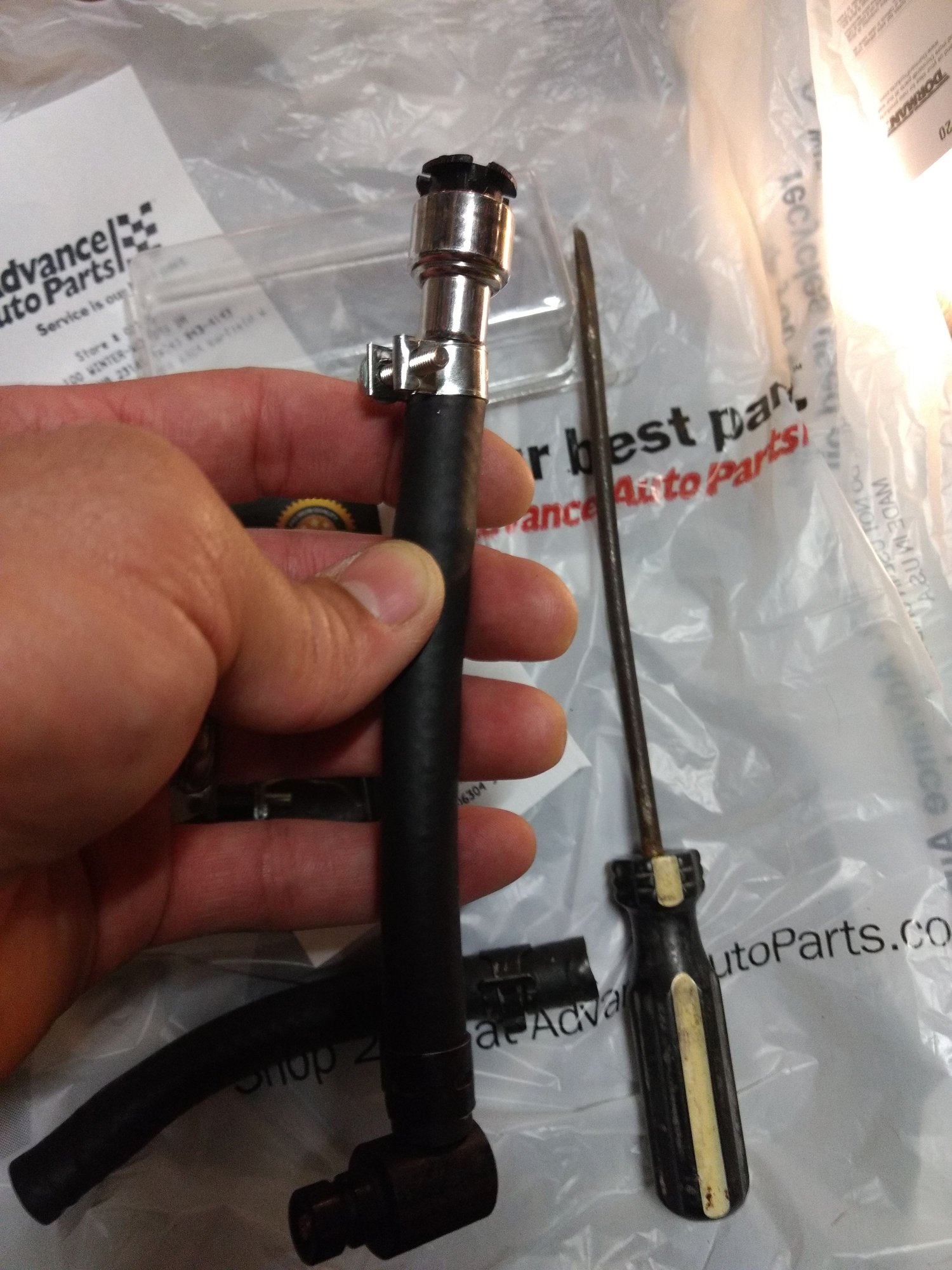

James Skelton's Avatar
James Skelton
Stage I
Joined: Apr 2019
Posts: 1
From: Virginia
Default Cheap fix
Originally Posted by Yesca
New to Forum, so here is my DIY Tip that I hope others can benefit from:
Here is a cheap replacement for the fuel tank-to-intake quick connect for fuel injected models in case the factory one gets broken and you don't want to pay $45.00 + dollars for a new factory piece of plastic & fuel hose .
Dorman p/n 800-120 is for a steel quick connect (5/16") ~$10.00 at auto parts store. Or Dorman p/n 800-057 for a plastic replacement quick connect fitting (5/16") w/nylon tube attached that can be cut off and removed ~$20.00 at auto parts store.
I used the steel one on my '07 FLHT and it works fine, no leaks.
I really appreciate your advice!! Worked like a charm and will probably Outlast the hose!! Thanks!
Got the part at advanced Auto Parts for $11.99
