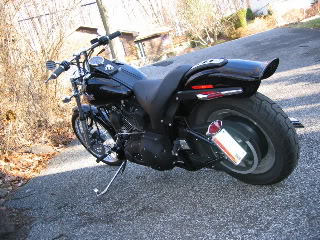

As far as plate and Tail light check into combo plate/tail light like the one on my bike below. (This one is no longer made) Other companies have similar type plates. Check JP cycles online. Get one that is LED. Much brighter than bulb tail lights

2005 nightrain
Carbed.
Stage I (Arlen Ness' K&N style oiled air filter)
Arlen Ness forward control extension kit.
V&H Straight shots
Radiant Side mount license plate light with LED cats-eye (discontinued)
Kuryakyn LED side rear marker/ turn lights
HD Diamond Back solo seat
