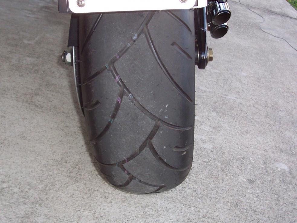

I have a 2008 Train, I have done a couple post lately on this subject. I went to Radials, 200/50/17 on rear, MH90/21 on front. Going to the lower profile on rear givers the gearing a real nice change where 4th and 5th are just right now for scootin around 45-55 MPH and 6th is now much more useable from 60 MPH up. Personally I feel the Radials really handle much better that the Bias tires. I am hoping the wear is better than the Bias as I was this is my 3rd set of tires in 21000 miles since I bought it new in March 2008. Hopes this helps!!
Attached Thumbnails Low Profile Tyres-100_0577.jpg   Low Profile Tyres-100_0592.jpg   Low Profile Tyres-100_0590.jpg   Low Profile Tyres-100_0594.jpg   Low Profile Tyres-100_0585.jpg
