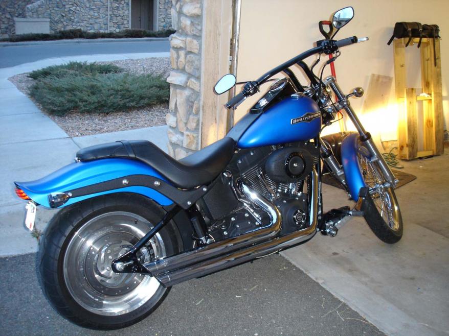

I see that you edited the post with the comment. I actually got the bars on a couple of weeks ago, I was just curious as if I had missed something as to why the holes were pre-drilled like they where. I thought maybe someone knew something about it I didn't. Anyways here a couple of pics of the bars on my Train.
Attached Thumbnails Bars pre-drilled in wrong location?-bars-1.jpg   Bars pre-drilled in wrong location?-bars-2.jpg
