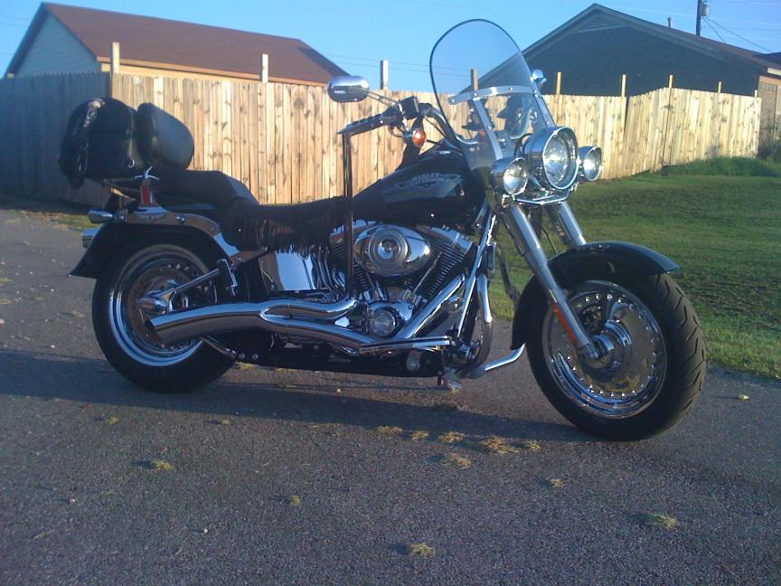

Originally Posted by TX_Harley_GI
Must say.....Thanks for ther Pic. Nothing like being able to see what the finished product should look like. Did you do the install yourself or pay someone?
Yes, I did the install myself. It is a simple install with basc tools. The headpipes and muffler is one assembly, however it will help to have someone help balance the muffler while you bolt up the headpipes.

I am only 40 miles from fort hood so if you need help installing anything let me know.
Also a chapter member of the CTH round rock. I used cardboard boxes covered in towel as support install the exhaust. also rubber gloves help keep you skin oil off the pipes and give you a good grip too
also the thundermax you wont need to have dyno tune to get perfect as it tunes as you drive and changes for altitude and load and fuel. cost a little more but well worth it and it replaces the harley ecm so no mounting issue
