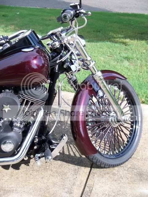

I'm runnen 38.5" Burly Brand BB with ChubbyWild1 risers and hidden clamp..IMO one of the best riser + clamp set-up out there...
ggod luck!

Risers are WO525 and hidden top clamp is WO535 http://wild1inc.com/503ct.html with beach bars your gonna need +2" cables...stock cables will not work...Good Luck...

We are runnen the same bars ....OS_Deluxe has a nacelle/clamp-riser cover which hides everything. Very costly $$$$ ...who knows what he got under those covers....
