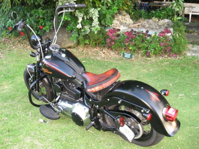

I have 16"s and went with 1 1/4" Bars with INNER TUBE SQUARES inside the Riser and Locked Tight Glue & Wrenched on the Bars ! I've Never had an Issue with Bars Slippin Ever !
As a Biker Rule for those of us with Ape Bars, Always Tork the Risers at least once a week ... Change out the Riser Bolts at least every 6 months !! If you feel they move more than to often its your Riser Thread or Bar Threads are Stripped - Change it out.
I've been Rockin the 16"s for over 2 1/2 Years on the Bones with No Complaints !!!!
Ride Hard Gentleman,
John Guam USA
Attached Thumbnails 12.5" apes keep falling down-img_0092.jpg   12.5" apes keep falling down-img_0104.jpg   12.5" apes keep falling down-img_0120.jpg
