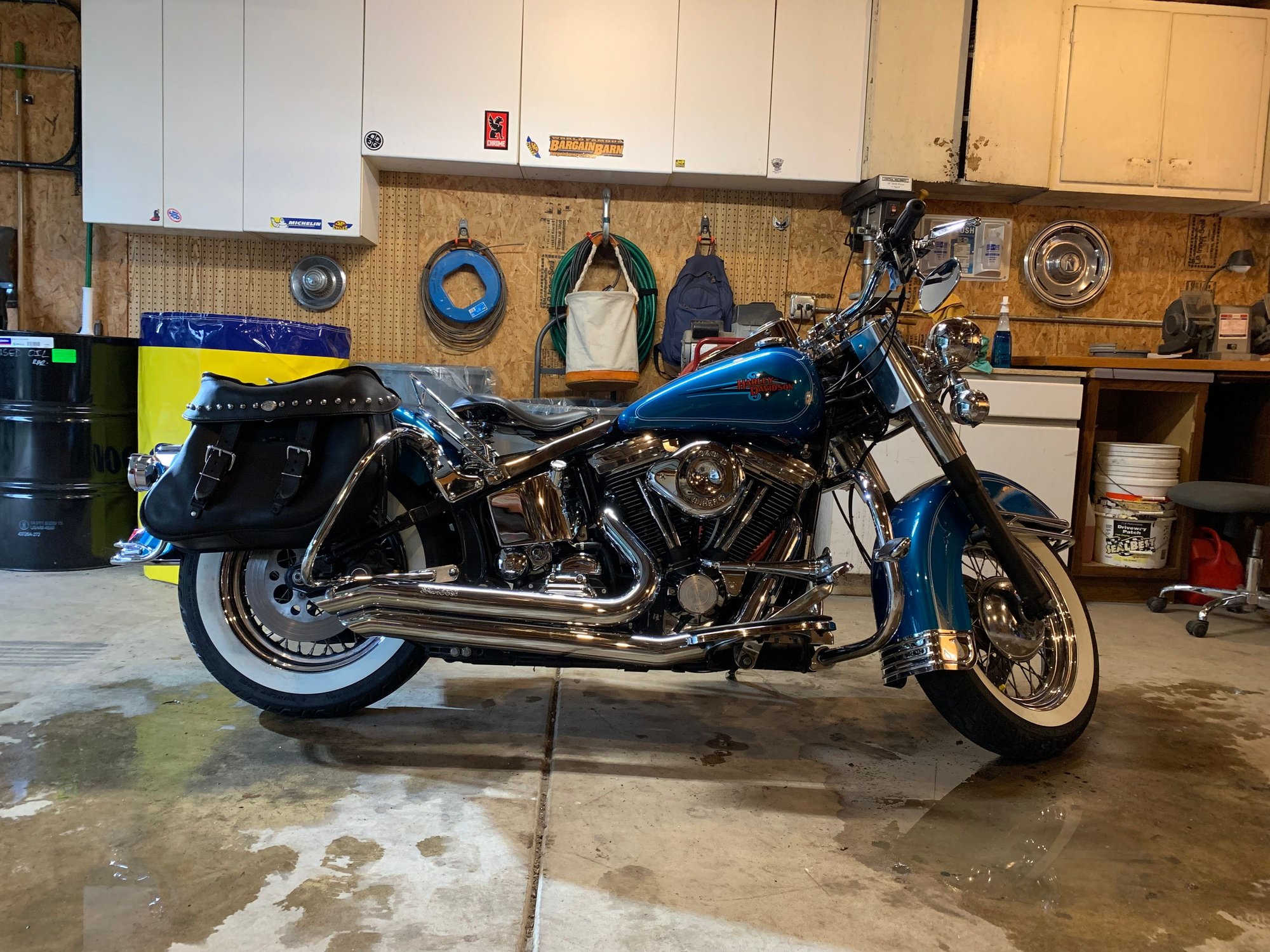

I’ve got Samson Legend Ripsaws, which are for Dynas, on my ‘94 Heritage. The rear pipe cleared the oil tank without any issues; the real challenge was correctly clearing the transmission.
Hope this helps!
