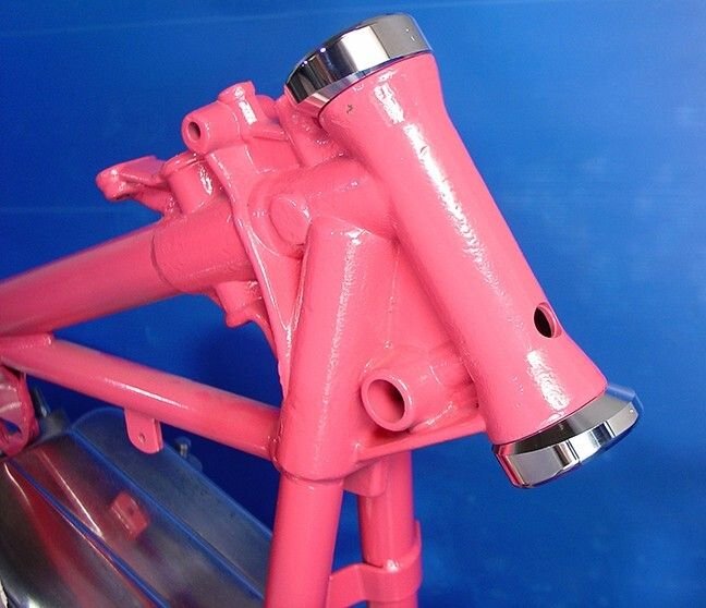

Here is an example of what the neck will look like with the racked cups. I don't care for the looks...
good luck,
T.
