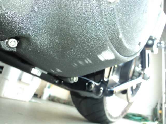

I think Harley apes are standard no matter what bike they're for,and they should fit the n/ train risers, i went with the chubby mini ape kit that Harleys do which i think look better and have internal wiring.
Good choise of bike. Mine's an 06 no problems so far,if yours is an 06 or earlier you will need to check the cam chain tensioners some time around 20,000 thousand miles or so,as they can apparently crack or start to fall apart.
