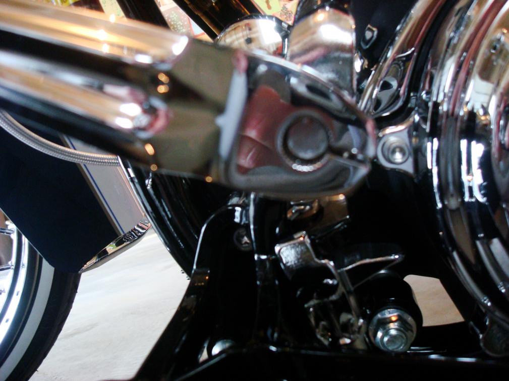

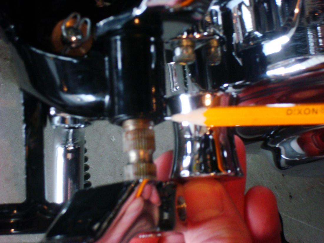

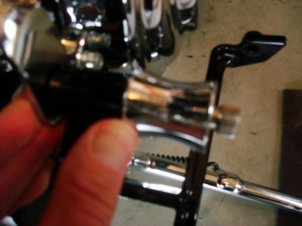

Got the PM contour shift and brake lever.Brake lever no problem.Got the shift lever with heel delete (spacer).The spacer is like a 1/4 " too big.I checked with PM Tech and have the right part # for my scoot.They said its the right part # but I am the first one to ever run into problems(that sounds about right for me).The first pic where the pencil is (no splines)is were the bolt for the shift lever runs through. So half of the splines on the shift lever catches on one side and half on the other.You can see in the follwing pics that isn't the case.In the last two pics you can see when the shift lever is installed properly how much bigger the spacer is.They are sending me two smaller spacers that will MAY BE ? get me where I need to be. If not I am just gonna have to trim down the bigger one to fit. Dont think I should have to if they advertise to fit my sled but what you gonna do? Any one else have this problem with this set up?

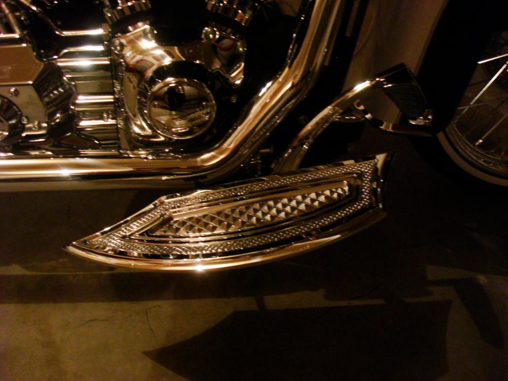

I must admit I am a little pissed. Nothing like going into the garage to do a 10-15 min mod and it turns into a cluster.Now I am waiting 6-7 days for the new spacers that MIGHT work.I really like the quality and look of the Performance Machine products. But this sucks. Here is the brake lever with my Eddie Trotta Floor boards.They look great together so I will make it work regardless.
