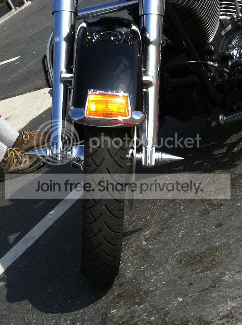

How about some pics from the front for comparison for our original poster. here is my 21x3 from the front.
Drew
