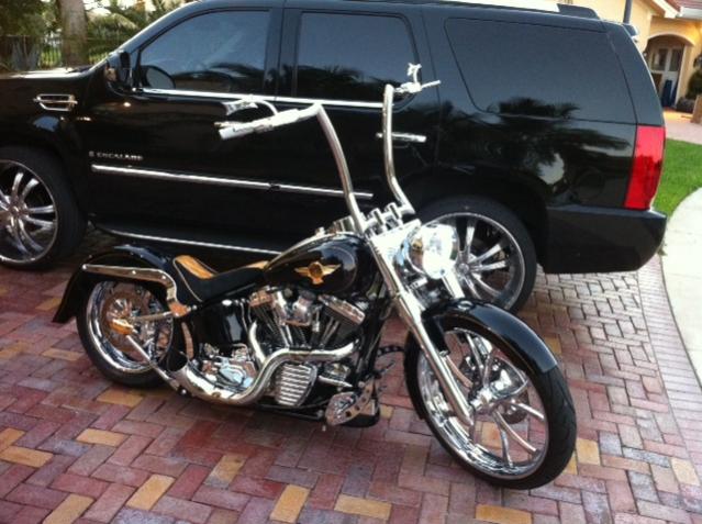

For reference, here are some shots of my buddy's bike with the HHI 4 degree trees and 23" front...
Attached Thumbnails Feedback on 21" wheels-rucco.jpg   Feedback on 21" wheels-rucco5.jpg   Feedback on 21" wheels-rucco2.jpg
