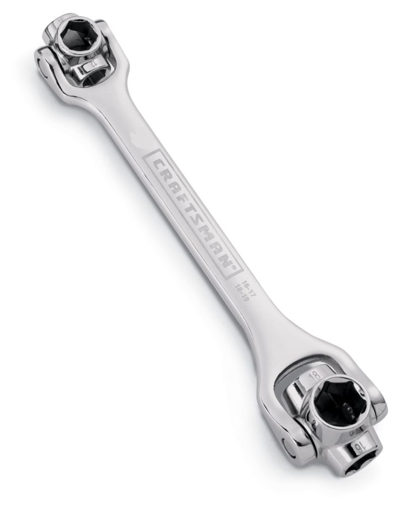

I ended up getting a Dog bone wrench to snug the nut up, U can put Ur allen T handle to hold the screw while tightening the nut up through it. Really helped make the job easier.
