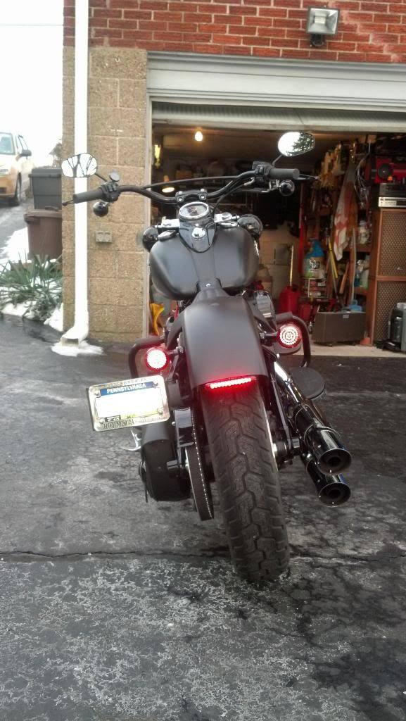

Here's a look with the new lighting - the picture doesn't do it justice.
Those LED's are freakin' BRIGHT - painfully bright even.
Ever have somebody shine a laser pointer in your face?
They're kinda like that...

Originally Posted by SoCalSoftailSlim
Haha. I like how bright it is. Would have to see on the road to really know. The taillight is great replacement to the stock reflector thats for sure.
I used that stock reflector mount for the new tail light.
I removed it, took the reflector off, cleaned it up and removed all the old tape.
Then I mounted the new LED light bar to it, and repositioned it further up the fender so that the light barely protrudes from under it.
I used 3M double-face tape, then added a good bead of Permatex Black around the sides and top for extra insurance.
It ain't coming off...

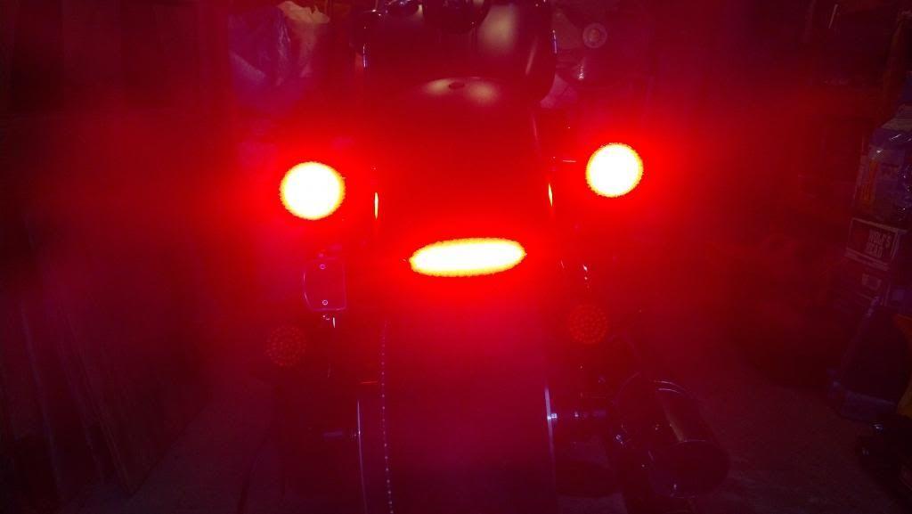

Here's a better idea of the brightness:
