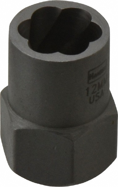

Need help please............
Old Sep 19, 2013 | 01:00 PM
Memo7070's Avatar
Memo7070
Joined: Nov 2008
Posts: 287
From: Tucson Az
Default Need help please............
Good Day All, so I have ran into a problem, i have a primary drain plug that has stripped out on me. What is the best solution to try and remove it? I don't want to retap, i just want it out so I can change the oil and put a new one, any suggestions?? I have a pic but not to familiar on how to post it. All info is appreciated.
Memo
Old Sep 19, 2013 | 02:53 PM
Sgt_Jim's Avatar
Sgt_Jim
Joined: Feb 2011
Posts: 3,048
From: Central Jersey
if you're draining it anyways, why not just remove the primary case and work at it from the inside? worst it'll cost you is a new primary gasket
Old Sep 19, 2013 | 03:07 PM
1004ron's Avatar
1004ron
Joined: Jun 2013
Posts: 1,781
Likes: 50
From: Louisville, KY
Originally Posted by Memo7070
Good Day All, so I have ran into a problem, i have a primary drain plug that has stripped out on me. What is the best solution to try and remove it? I don't want to retap, i just want it out so I can change the oil and put a new one, any suggestions?? I have a pic but not to familiar on how to post it. All info is appreciated.
Memo
I take it that its the flats on the outside and the Hex key on the inside of the plug head that's rounded (stripped), because if it was the threads, there's no way you're going to be installing a new plug without fixing the thread.
If it's a rounded hex head, you can try one of these:
http://www.mscdirect.com/product/021...S&026=nv&025=c
Or try an easy-out on the internal Allen key hole.
If the plug is still tight and sealing, and you have enough clearance with the Derby cover removed hand pump the oil out with one of these:
http://www.walmart.com/ip/Oil-Change-Pump-Kit/11071257
Last edited by 1004ron; Sep 19, 2013 at 03:28 PM.
Old Sep 19, 2013 | 03:07 PM
08Nighttrain's Avatar
08Nighttrain
Joined: Dec 2011
Posts: 1,122
From: Florida
You may have to drill it out. You say it is stripped, do you think its the bolt or the case that is stripped?
Old Sep 20, 2013 | 07:26 AM
oct1949's Avatar
oct1949
Joined: May 2007
Posts: 145,895
Likes: 821
Bolts are steel, case is alum.. if stripped its prob the case... not the bolt..
laserman2431
Sep 21, 2012 02:24 PM
Turbo Turtle
38
Aug 15, 2010 02:57 PM
kraig205
Apr 30, 2008 04:05 PM
bdavis
Ironhead
18
Jun 15, 2007 12:31 PM
dawg
Jul 23, 2006 05:56 PM
All times are GMT -5. The time now is 02:09 PM.
