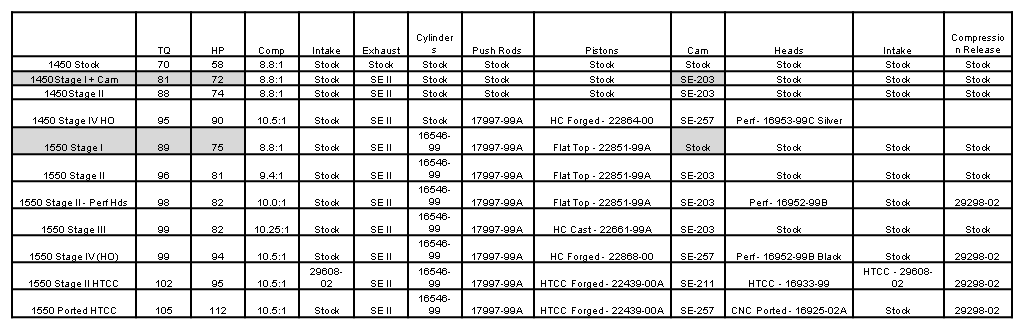

I see you have an '02 Twin Cam so attached a couple spreadsheets I made years ago for my '03. performance head part numbers are in the Race Stage chart in both silver and black. Try typing in the numbers on ebay and see what is available. I think if you double click on my thumbnails the picture will enlarge to read
Attached Thumbnails Hand porting heads-chart1.png   Hand porting heads-chart2.jpg

OK that didnt work....
Harley Screamin Eagle Performance Heads
Black - 16952-99B
Silver - 16953-99C
Harley CNC Ported Heads - 16925-02A
and HTCC (High Torque Combustioon Chamber) - 16933-99 (Requires HTCC Intake)
