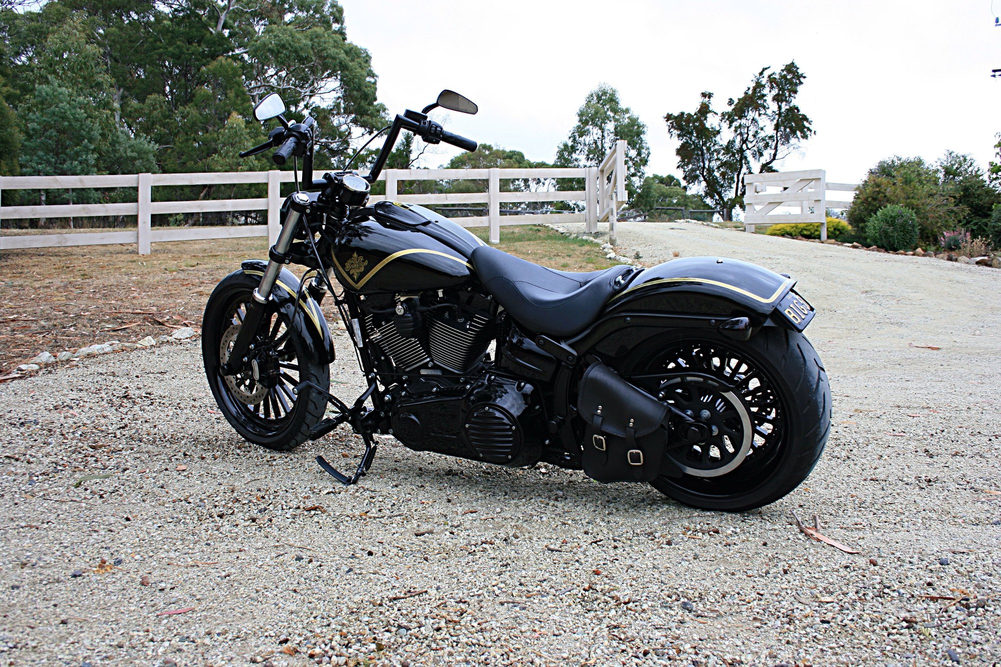

All back together after new paint.
Old Mar 20, 2017 | 08:32 AM
  #5499
LA_Dog's Avatar
LA_Dog
Posts: 3,185
Likes: 189
From: 90210
^^ Wow- Very nicely done. Top notch!
