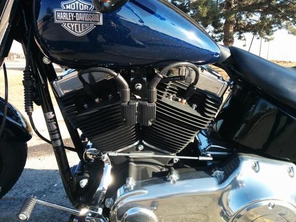

I put a DK coil kit on my 2008 Night Train 2 weeks ago.
I love the kit, and the effect of opening up the backside of the rear cylinder after you remove the former coil bracket.
I did scratch my head over one thing in the kit. The Harley harness you are extending comes with a nice water resistant plug that one wires connectors into. Ok. But the plugs are way bigger than the factory plug for the coil. So there is some slight fabricating there. I thought it would be easier to sell a harness extension that was the same size as the factory, and in the same pins as the factory. But, I decided to solder the wires together, and skip the bigger plugs. Took a littler longer, but super clean install.
While doing this, I had drawn out a schematic of color wire extension-to-factory-color wire. Even with this, I caught myself almost cross wiring a pair of wires. However, I caught it, wired it right, and the bike fired right up.
I love the kit, but would like to see a direct plug in wiring harness with their kit. It would make it so simple!
Saying that, I did buy the deluxe kit with everything, and would recommend it anyway. Love it.
And yes, I agree, you either wired a pair wrong, or your plug connectors are not secure.
