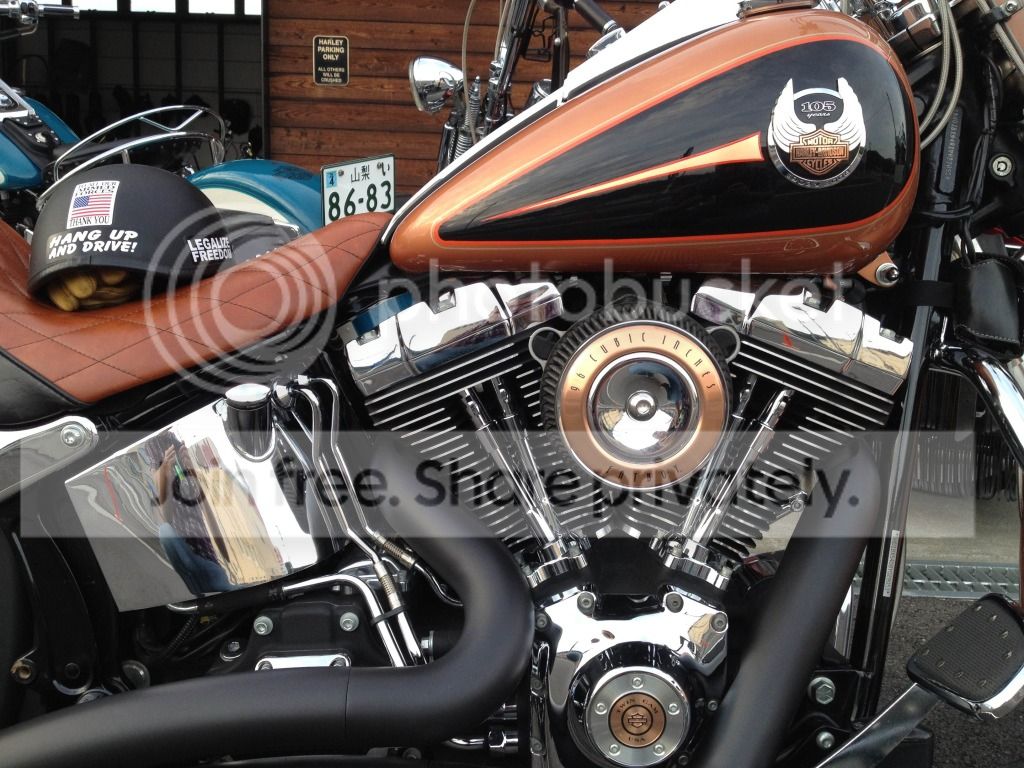

Not into those $400 fashion statement jobs that every one else has. Like to keep it simple and do things myself when I can...
