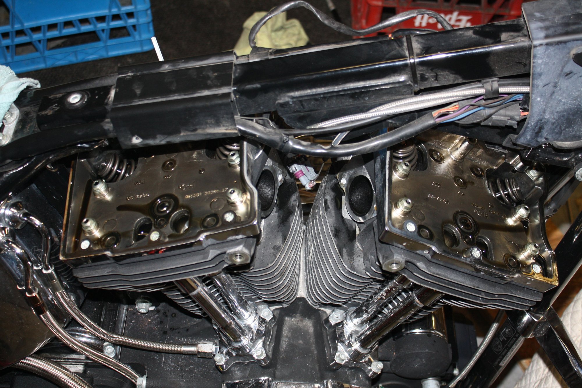

push rods can be removed through rocker box
rocker box

My bad, I meant to say rocker boxes!
