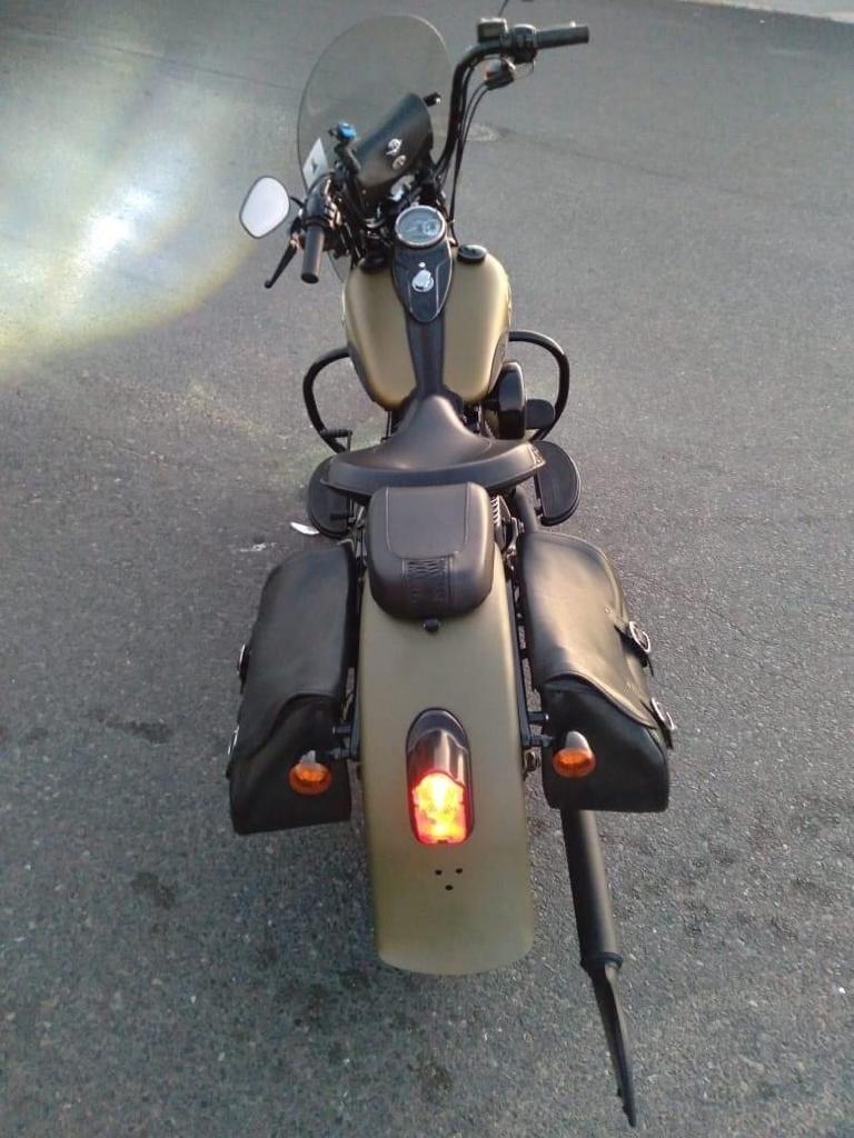

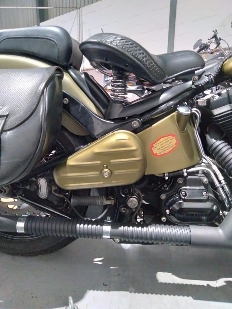

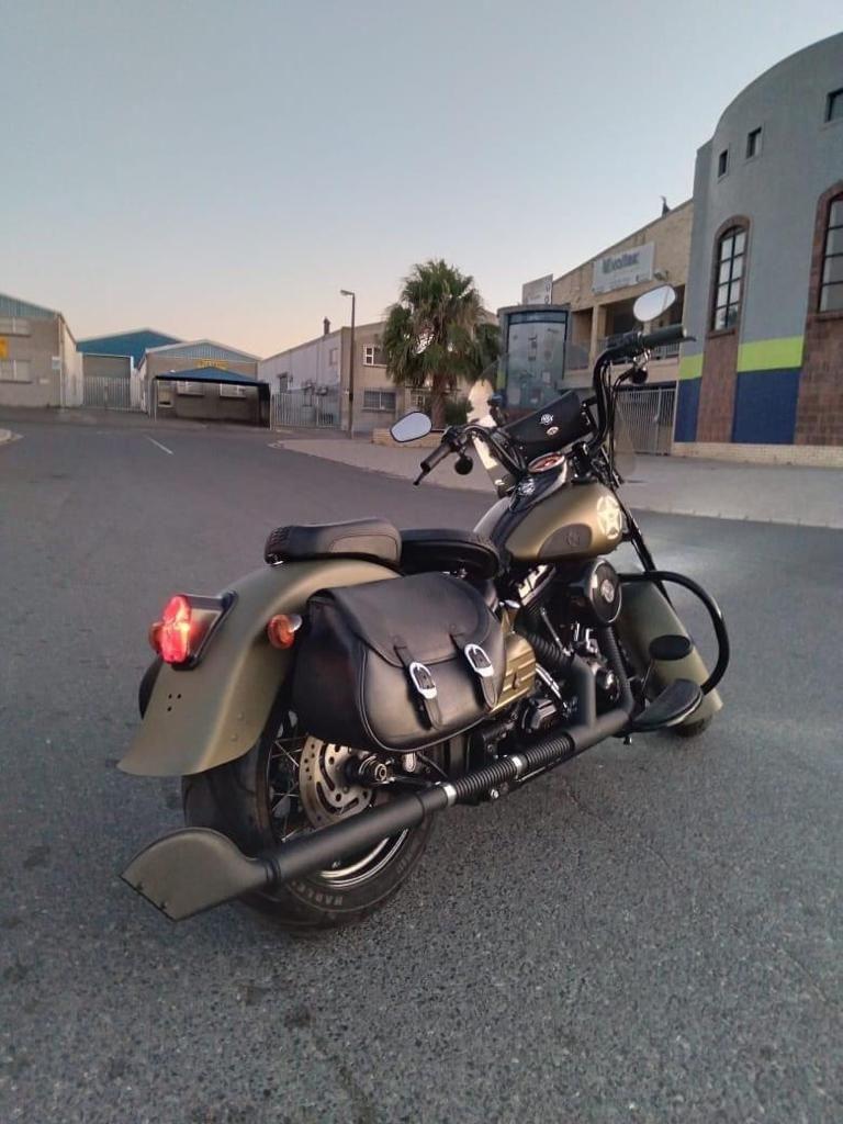

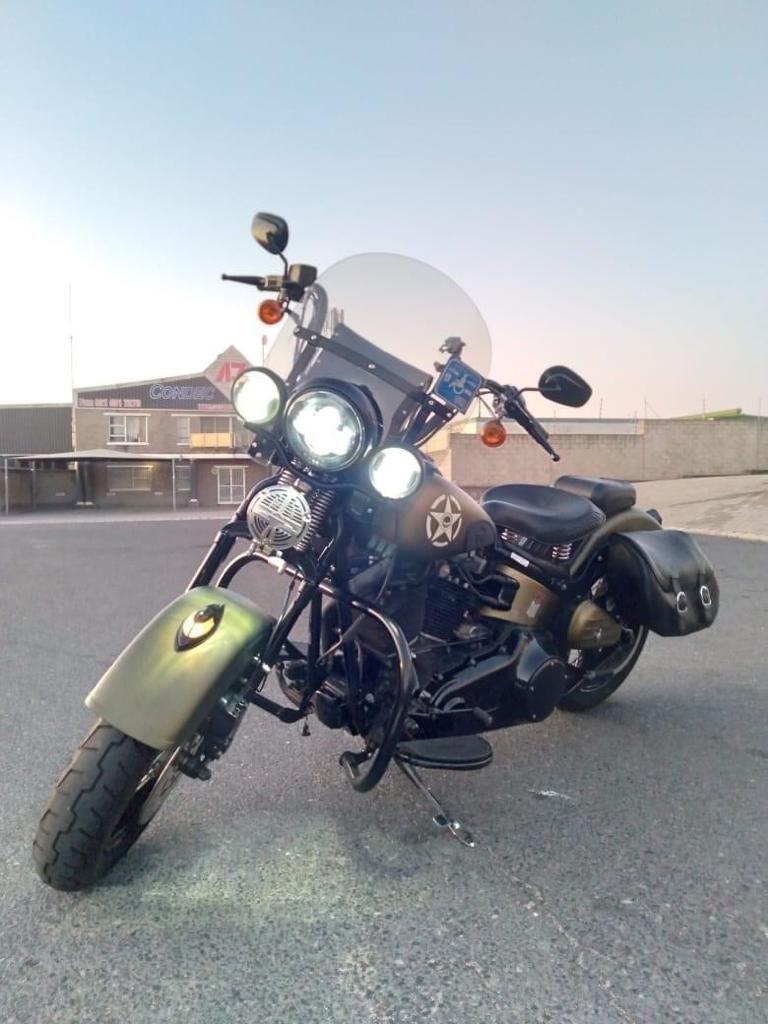

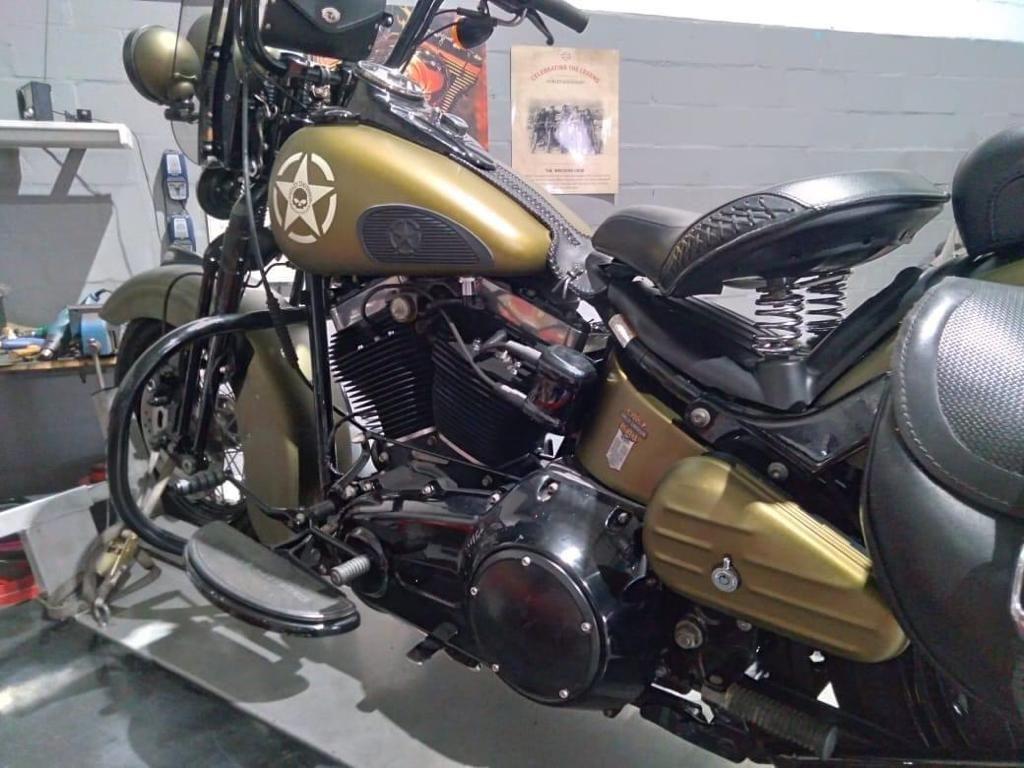

A few pics of my South African ride, as it stands now:
Right side, showing exhaust detail, toolbox and oil tank detail
Front view - 7" Fatboy headlight, and 4&*1/2" spots, all LED
Left side, showing tank pads, tank logo, toolbox and oil tank detail
Back view with stock turn signals, stock seats, and tombstone taillight

Originally Posted by MilsurpShooter
I've seen that style exhaust a handful of times on the Crossbones and gotta say, soon as I find a place who'll make me one, that's what I'm putting on my bike
@MilsurpShooter almost all of the parts bought off eBay:
Header: 2 into 1 Exhaust Pipe Header Chrome fits Harley Davidson | eBay
Muffler: 34" Shark Fin Custom Cruiser Vintage Motorcycle Muffler Fishtail Chrome 1.75" | eBay
Flexible Covers: Flexible Exhaust Cover for Harley Davidson by V-Twin | eBay
Hard cover for the 2 into 1 "Y" joint was made from the heatshields of the OEM exhaust cut to match & welded together.
Wide band O2 bungs: 2 set O2 SENSOR WELD IN EXHAUST STEPPED BUNG + HEX PLUG KIT STAINLESS M18X1.5 | eBay
Test fit to the bike with a few generic exhaust clamps to make sure it all worked, then sent for CerraKote (high temp matt black ceramic powder coat) - not perfect, but beats the alternative - the shabby titanium fabric exhaust wrap.
Hope this helps.

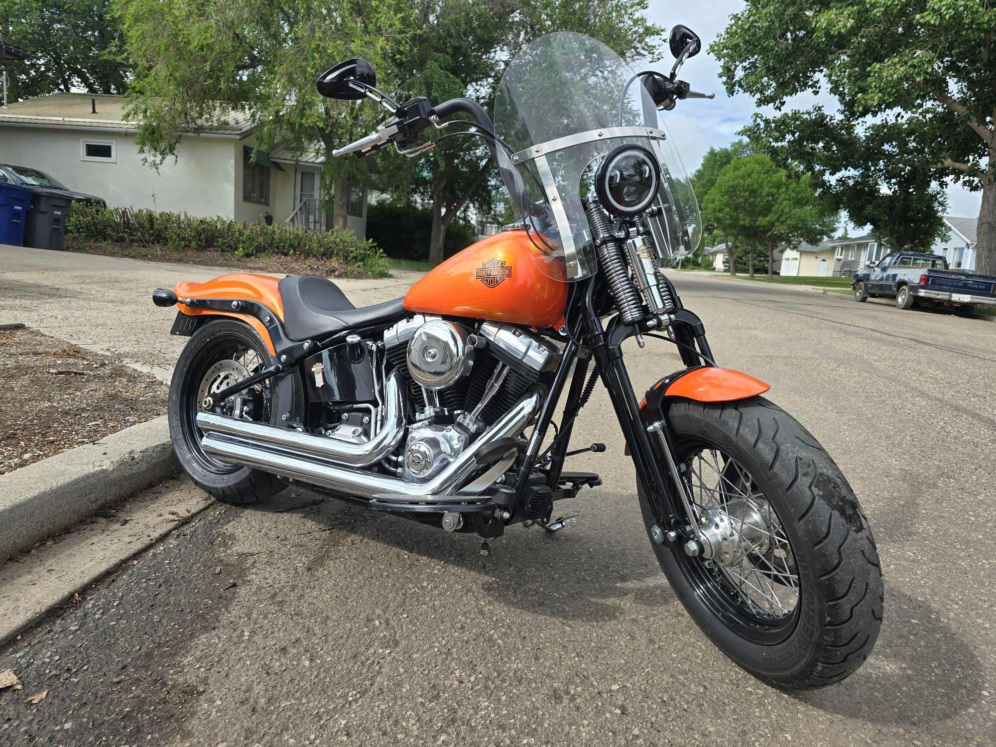

Here is my 08
