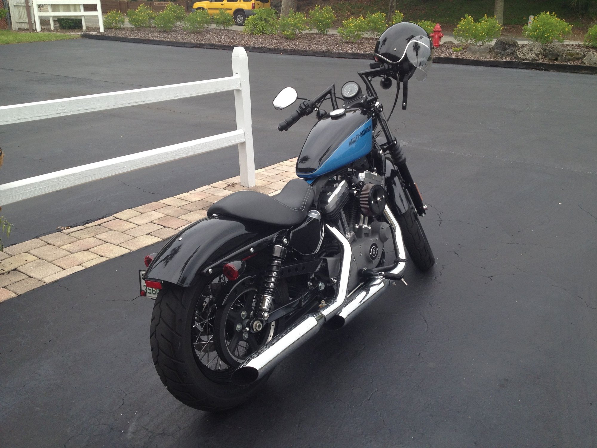

I guess this is where I post this, I couldn't find a separate forum for sportsters only. Please move it if I am wrong, sorry.
But I just got hit by a car a month ago and have money to fix my bike, luckily it was there fault.
I want to get a different set of bars (I think), but I don't want to have to do any cable work (such as have to buy longer cables or anything). I want something with a little more pullback than the stock bars because I am a short guy, 5 foot 2, and a little pullback would help. I wouldn't mind 2 inches or so of rise either, as long as my stock cables would reach. Any suggestions on what bars to look at? Z bars and T bars look sharp, but I don't know the rise and pullback of the stock bars so I really don't know how to make sure I am not needing to buy new cables and do a lot of cable work.
Thanks guys

I have an 08 nightster. At one time I was looking into different handlebars,(mini apes) but for the cable change costing more than the bars themselves, I found it cost prohibitive. If you are going to go with aftermarket bars, you can probably compare them to genuine HD, (dimensions) using the HD catalog. The catalog will tell you whether or not different cables, and/or wiring connections are needed. In true HD fashion, anything cool is going to cost you.

Compared to HD badged cables, you can save more than 50% going to drag specialist, the parts guy at my local HD helped me size cables and ordered them for me. By rerouting cables, with bars not drastically different you could likely get by with just brake line. On my wife's Iron, I ordered some simple 1 1/2" risor extensions from DK Customs, did not have to replace anything. That small amount made a difference.

I installed a set of nightster bars on my 48 shortly after purchasing it.
Here's a spec sheet for comparison.
http://www.sideroadcycles.com/Import...ckBarsOne.html
Your stock bars should be 6" height 32" wide 10" pullback.
There are a few bars that might meet your needs.
The harley bars ran about $80.00 for mine.
If you don't go more than 2" in any direction , the stock cables and wiring should be able to be reused most of the time.
