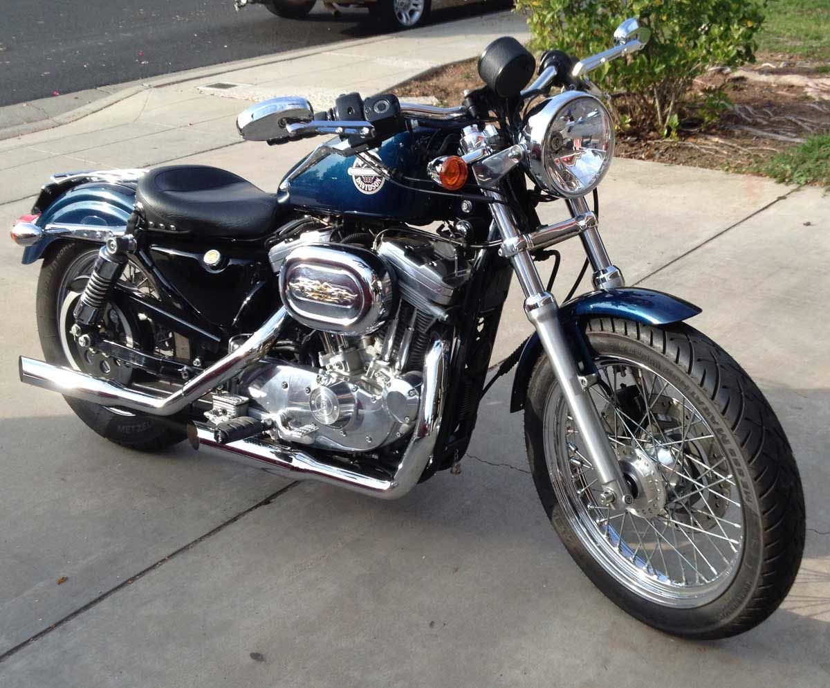

I seem to have a thing for classic British styled bikes. As such, that seems to be the direction my 02 Sportster has gone.
The latest modifications are the wide low bars and a 7" headlight. Of course the headlight is as functional as much as having the look I like. I used "ears" that mount to the fork tubes rather than a single top or bottom mount.
I had the Biltwell tracker bars on it before, but these have just about an inch more rise and a couple inches more pull-back. Along with a set of Iso grips, it totally transformed the feel. Much improved.
I also recently installed a Ness Big Sucker air cleaner. (not in the photo). I thought I was ordering a stage one, but due to inattention, got the stage 2 instead. I got drawn in by the grooved cover.
The cover is over an inch and a half bigger in diameter and sticks out an extra 1/2" over the stage one. My leg hits it. I don't like it. I think I'll switch it out a little later.
I reckon not much on this one left to do other'n ride it!
Although, a set of.......OK, maybe there is stuff left to do!

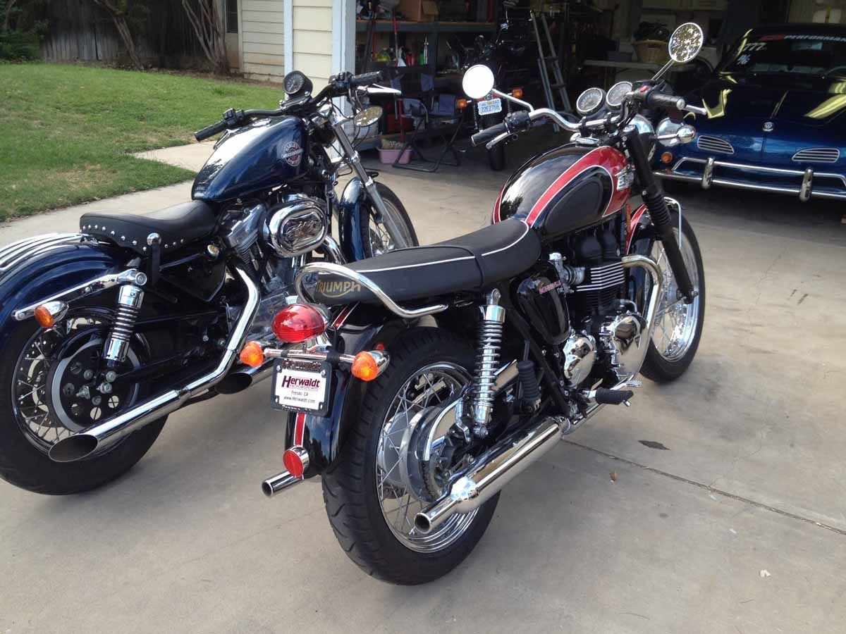

Just so happens that a Bonneville is the Sporty's stablemate!

Mike, tell me more about that headlight setup...I am looking for the exact same thing...and where did you get the parts...any issues hooking it up or removing the original setup???
Old Dec 5, 2014 | 08:22 AM
Mike Lawless's Avatar
Mike Lawless
Joined: Jan 2014
Posts: 2,181
Likes: 488
From: Central California
Thanks for the compliments guys!
The headlight and mount ears came from here….
http://www.dimecitycycles.com/7-inch...with-bulb.html
No real issues. Two of the deutsch connectors had to be disassembled to get the wiring harness out of the original bucket. There's a few you tube videos on that. Much easier than I initially thought it would be
The new headlight has one big hole, so all the wires have to go through that.
I couldn't fit the speedometer connector into the bucket because those wires are too short. They were underneath the original hood and out of sight. They're still out of sight after a minor reroute, but a clean-up of that will be for another day
