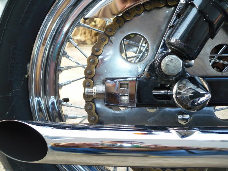

I bought a DID X ring 110 link chain new 21 tooth PBI front sprocket and a new 48 tooth rear, I like the stock hearing has a lot of pep, also bought these chain adjusters from V-Twin, makes adjusting a snap.

I looked on V-Twin and for my year they have the stock one listed for adjusters.

V-Twin PN is 44-2011
