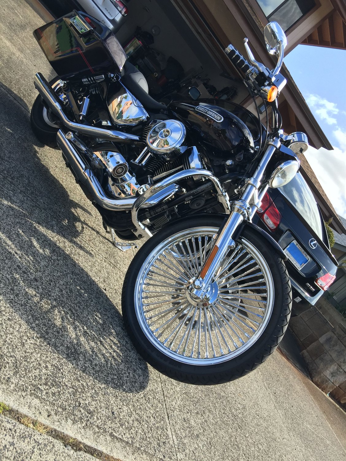

In my opinion, I would look for other suppliers that have the size you want and offer competitive prices. Narrower tires will affect ride and look. To put it in perspective, here is a pic of my front stock tire 100/90-19 versus 90/90-21. Of course the 21" will be taller, but the example is just to provide a point of reference. I went with narrower tires mainly to ensure fitment of the taller wheel in the stock fender.
