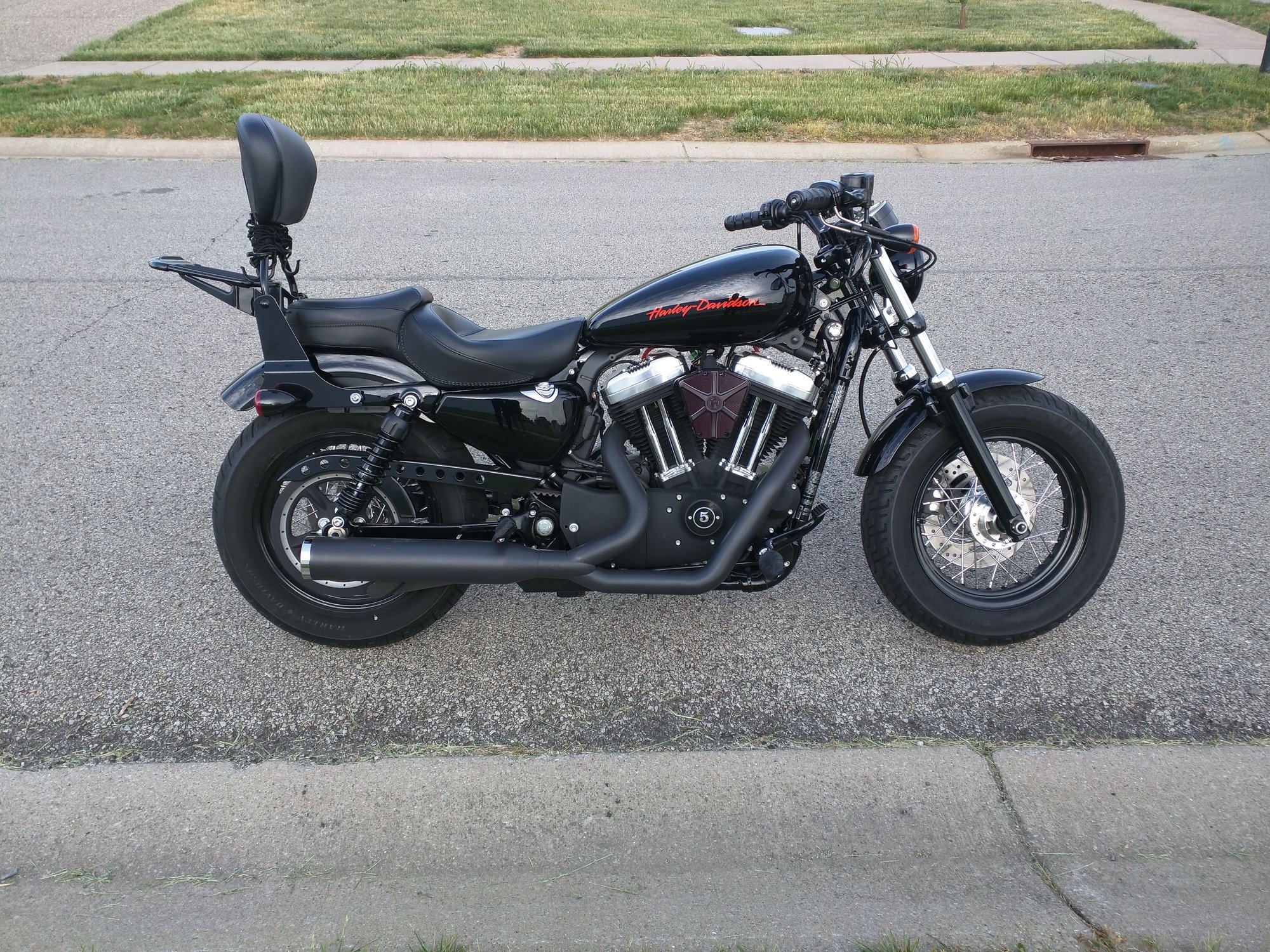

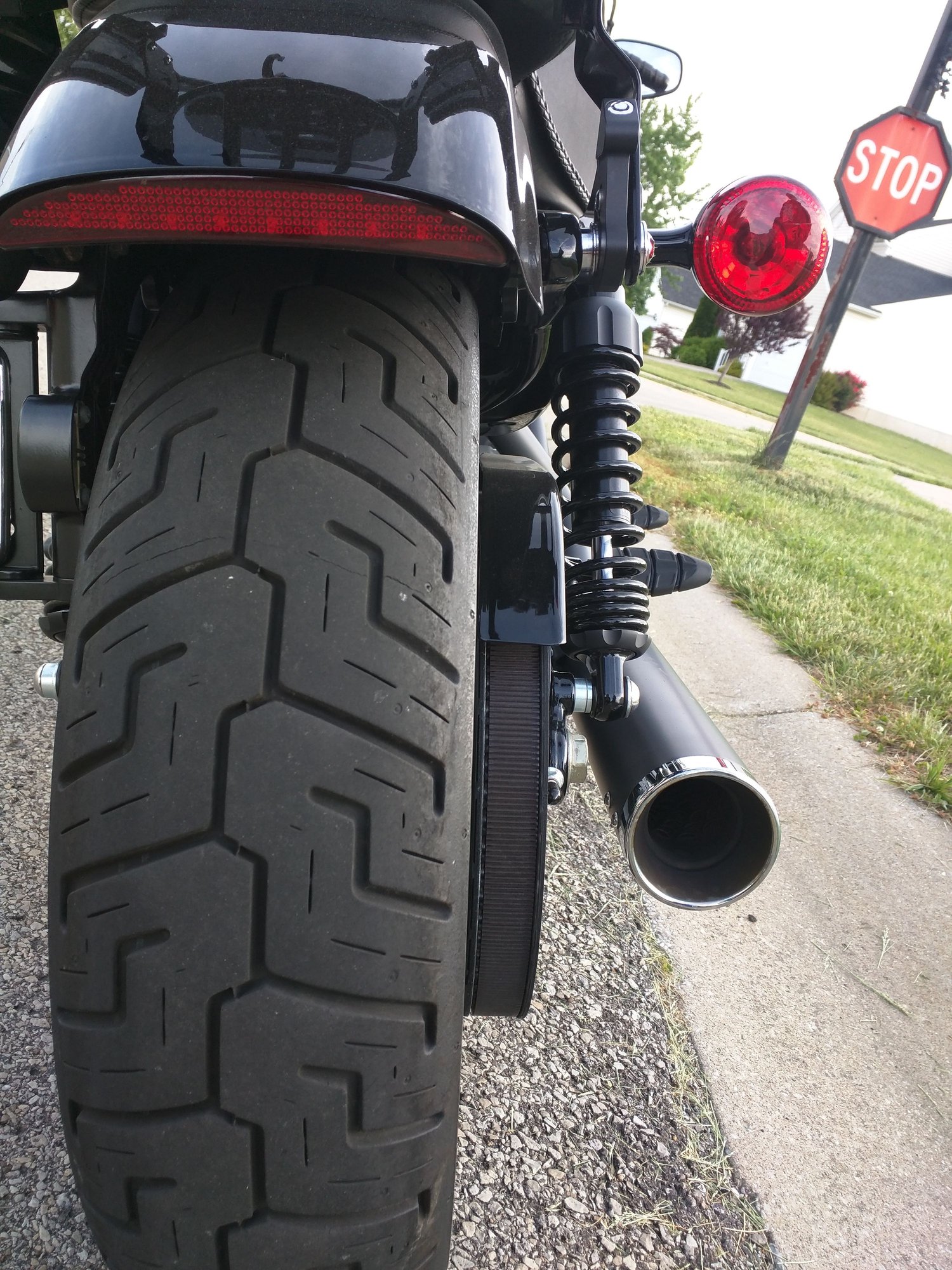

Not sure if this helps but here is my 48 with the 12.5" 444's.
