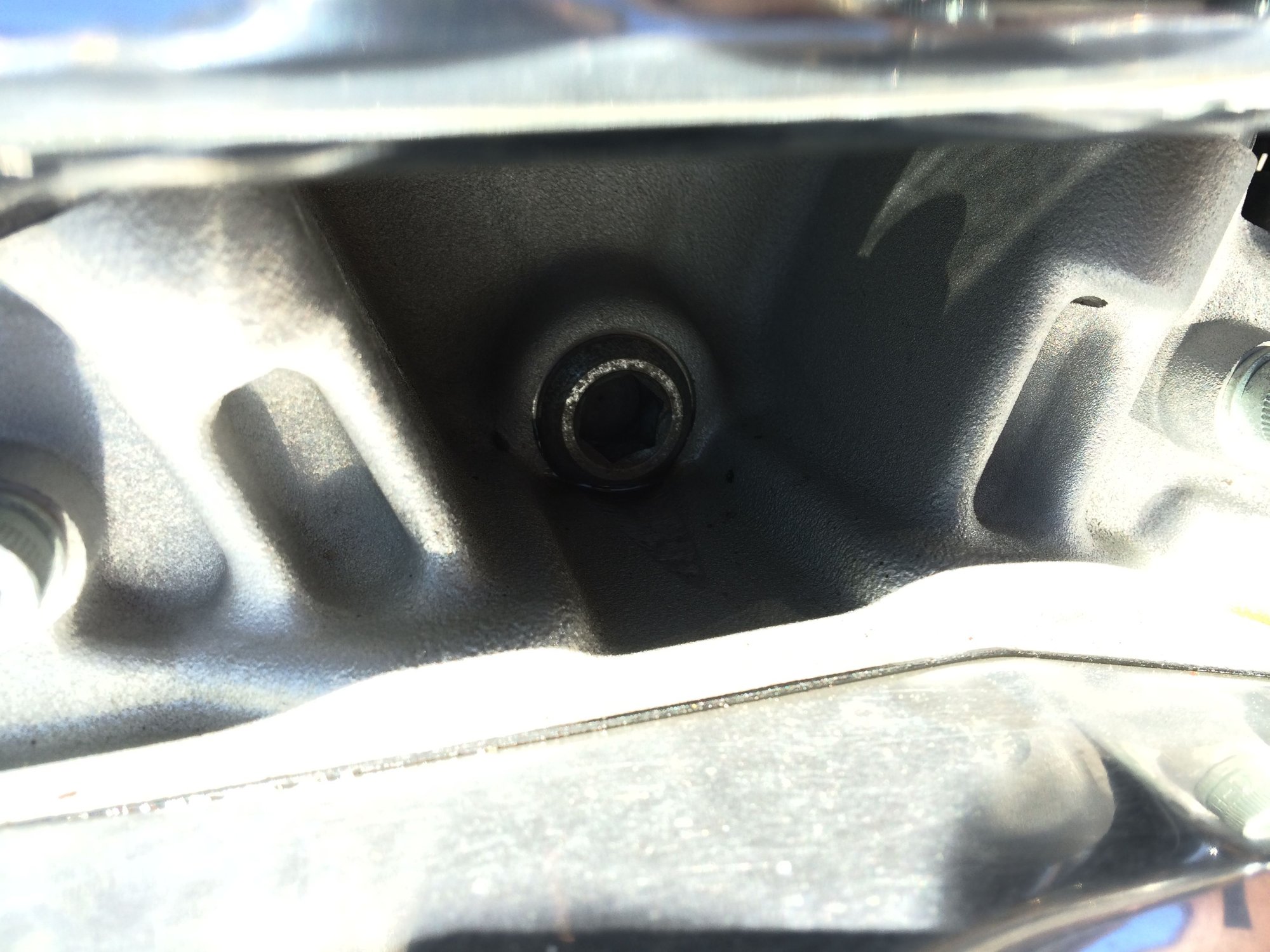

So I just noticed a little oil leak on my 01 sporty. It doesn't look like it's coming from the breather bolts, nor does is it something that's tricking down from the head cover either (both well known for leaking). I'm going to attach some pictures so if you guys have any insight, it'd be greatly appreciated!
oil puddle on the right side
possibly coming from this bolt?

Have you tried wiping your hand underneath the air filter element to see if oil has been collecting in it?

I just stuck my hand underneath the air cleaner cover and there was definitely some wet oil there. So yea, now I'm assuming that it's tricking down from the air filter into that little pool and the road wind is carrying it to that center bolt crevice?

Yup. most likely. Also, check your oil level too. Too much oil will do that - if you have breather bolts this shouldn't be happening.
I would also remove the filter and clean it out. otherwise that portion of the filter stays clogged with oil, reducing airflow.

Should be OK to just wipe clean and go -simply keep an eye on it. Owners of older Harleys used to take pride in their leaks.....

i'd put $ on it coming from a drenched air filter from over filling oil tank.
