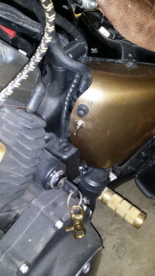

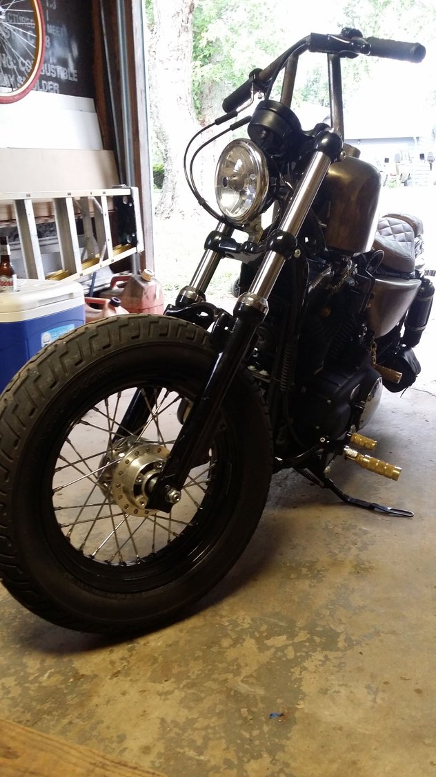

All I did was pull the tank un plug the pods then took the switch housing apart and cut off what I did not want to keep. then there was plenty of slack to run back to my battery cover maybe a hour or so it took.

Nice looking bike. What year is that.
Old May 20, 2015 | 01:44 PM
kountry's Avatar
kountry
Posts: 821
Originally Posted by iarecobra
nice looking bike. What year is that.
2010 48

I did forget the head light locate on the plu going into the harness for the hi and lo you will have to splice behind the plug to complete the circuit. since the switch is going away. I didn't do the toggle for hi and lo I just wired my hi constant and have had any issues.
