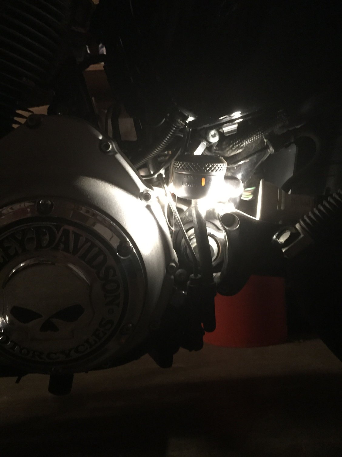

Rear swing arm bolt not centered
Idea of where pic was taken

I started to notice a vibration at times last year. Before I take the bike out I started to go over it and noticed this, is it normal? 2008 sportster 883c.

Can't tell from the pictures. You definitely have ware parts in there. Have you put the frame on a stand and seen if there is any play? Check torque specs. Maybe your wheel and tire are out of balance.

Yes, thats the rubber part of our rubber mounts They wont be centered.

I saw it off centered and thought that was the source of my vibration. The vibration happens at different times. Sometimes at idle sometimes at decell. I am checking Torque specs later today.
