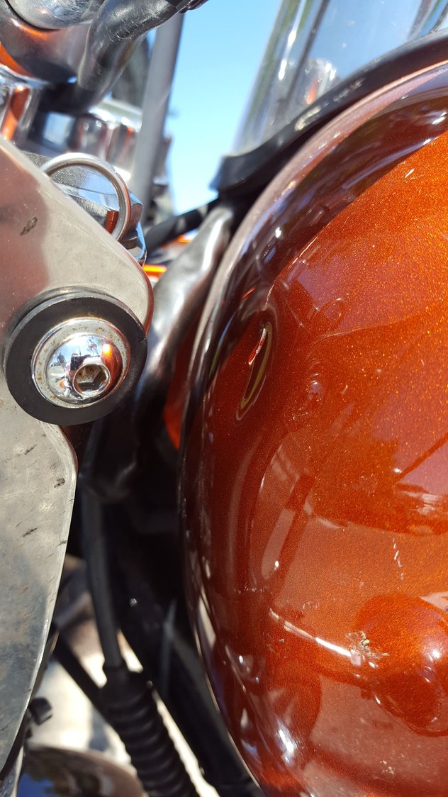

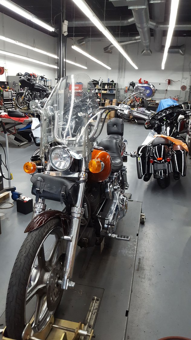

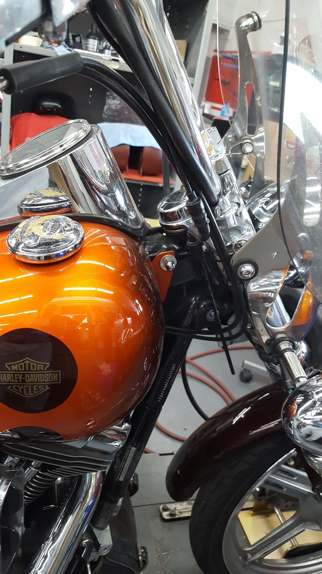

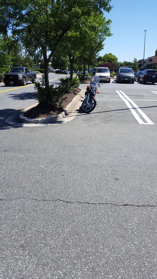

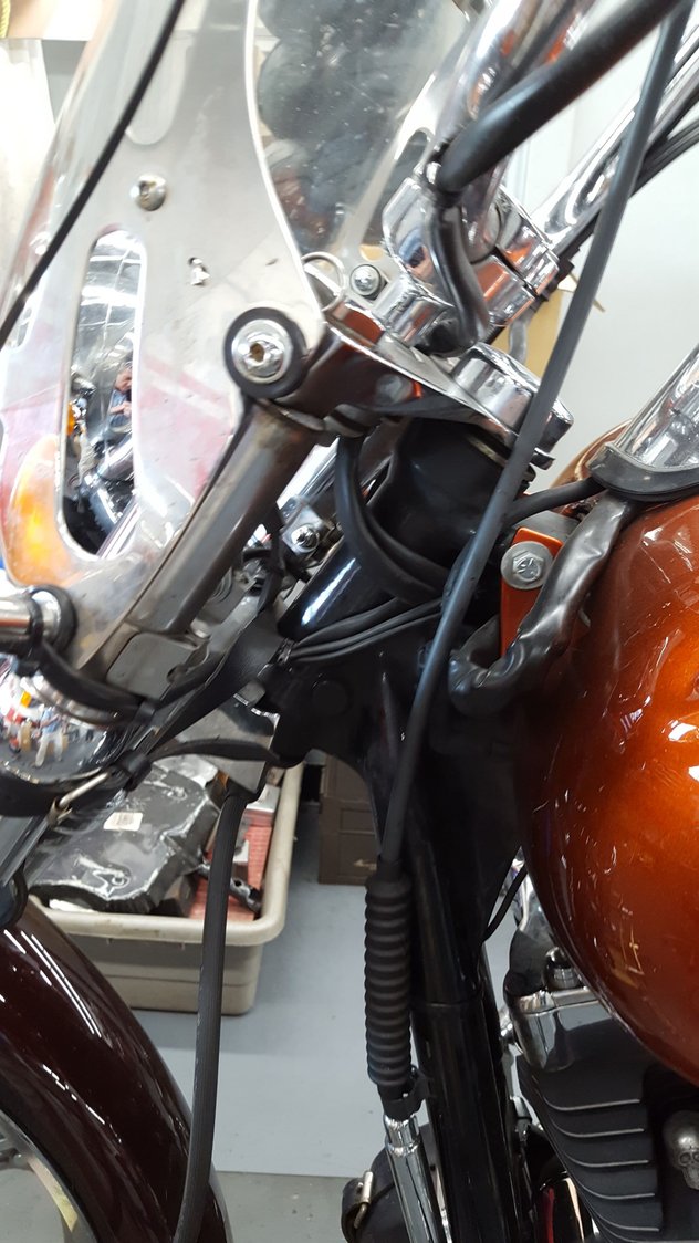

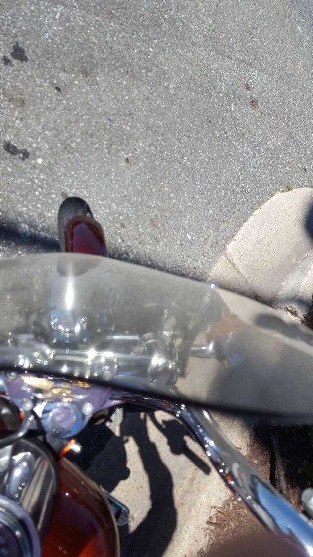

Here's some photos, from the day of the incident and in the shop. It appears to me that the bike was hit pretty much straight on from the front, probably by an SUV or pickup backing out from the facing space, thinking my space was empty. Just a guess, since bike has a relatively small and low profile. Looks like the impact was hard enough, and high enough, to drive the front wheel into the ground judging from the scrapes on the rim and the pavement scrapes from wheel and kickstand. The wheel itself appears relatively intact, no obvious cracks, bends or breaks other than the scrapes. Need to pull it and see if it balances on my handy-dandy home balancer. Tire holds air just fine. Frame looks OK to me as well, no obvious damage to my untrained eye.

If your bike was a bagger the crash bar would be mounted under the neck on a "tab" of sorts. If that spot is tweaked, cracked, bent etc....Harley says bent frame every time
