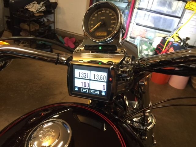

I ran ViED which is similar to XiED except the ViEDs are variable/adjustable. Very inexpensive option if your are on a budget, but it does not optimize your tune/performance. I adjusted the ViEDs full range and only could minimize (not eliminate) the decel popping. FuelMoto Micro EFI is the next best thing, but I went directly to the Dynojet Power Vision with Autotune. Both were my top two tuners in my selection process. PV is a flash tuner so it does not need to stay on your bike, but I keep it on the bike to monitor engine temp, rpm, battery voltage, and gear....there a many other things you can monitor. It is a big difference in price ($300 more) from the FM Micro EFI so again if you are on a budget, the Micro EFI tuner is an excellent option.
Oh and no more decel popping and smooth throughout the power range. You probably can get the similar result with the Micro EFI.
Here is a look at the PV monitor with gauges (also has analog view options)
I purchased the tuner from DK Customs and obtain technical support from Jamie at Fuel Moto. Both are excellent when it comes to responsiveness and customer service.
