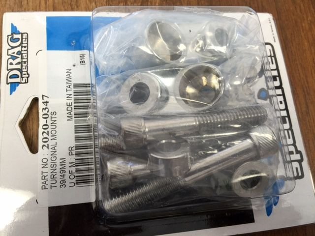

Okay, received the drag specialties relocation kit....looks well made, but need to buy two socket allen head bolts to install the turn signals. I am assuming it is 5/16-24 fine thread.

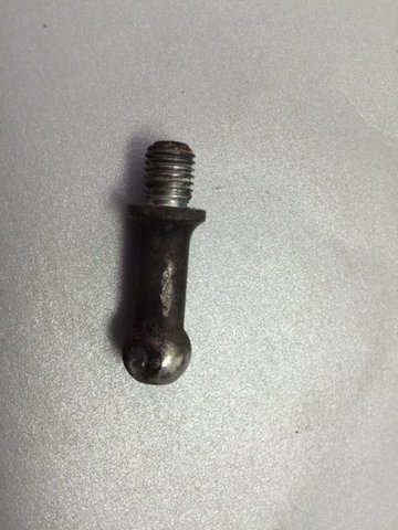

Got one of the allen head bolts out of the turn signals but the other is a bitch to get out...frozen. I applied WD40 and let it sit overnight, applied brake cleaner to dissolve any corrosion. It is difficult because there is no leverage out of the housing and hanging from the wire. Any helpful hints, insight, tip, or tricks on how to get the bolt out? Here is the one that came out.
Always seem to encounter glitches when trying to get something done on the bike....sooo irritating. Any help is greatly appreciated.

Originally Posted by damager1
Hey there dude! Awesome job with this relocation. I'm about to do the same with my Dyna FXD. Just a quick question for ya, when you bought those 2 replacement socket head allen bolts, how long did you need to get? Not sure if I should get a half inch, inch, etc?
I'm about 99% sure that the FXD bullet turn signal is exactly the same as the sportster ones, so that shouldn't be a factor here.
I bought 1/2 and 3/4" since I was not sure myself. The 1/2 was a little too short if you use a lock washer....so I used a 5/16-24 X 3/4" with a lock washer. My decision was based on the exposed thread of the original bolt i.e. the length that went into the turn signal and worked from there. The original bolt thread portion was about 3/8" in length. Someone else on here used a 1" which was perfect for him. Since there is no stopper in the turn signal and uses the signal casing to stop and tighten to the mount...you have some flexibility. Just make sure it is not too short so you can securely tighten the bolt and not too long that it interferes with the electrical in the signal...and be sure to use blue thread locker.
