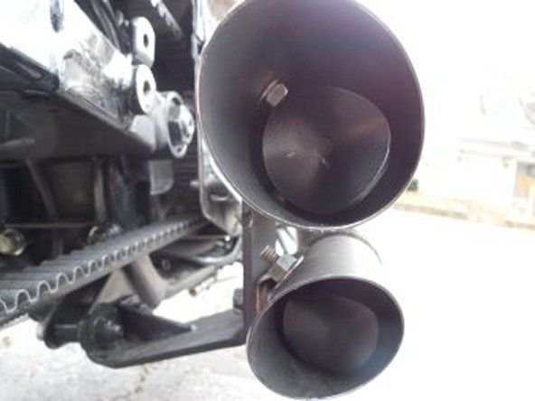

I responded to a post titled (W158 TTIs into Vance and Hines short shots) I stated in the post that I made my own lollipops. Kevin form DK Customs responded in the post and asked me to try out his W158 TTIs vs. my homemade lollipops and post the results in the forum.
The bike I used was a 2000 Sportster 1200XLH. Stage 1 with Vance and Hines Short Shots.
The jets are 45 low 185 main and a fine tuned fuel/air mixture screw with a setting that is secret even to me. Only defect I have found is that when I go through the first few gears the front tire always wants to come off the road.
The first thing I found was the bolt on the TTIs did not fit the hole size where my baffles were bolted originally. Fortunately the metal is very soft on the Vance and Hines pipes so I drilled the hole larger with a visegrip and a drill bit without removing my pipes.
The W158 Thunder Torque inserts were larger than my lollipops but they fit perfectly. Upon starting my bike I noticed a big difference in sound. The tone was deeper and a lot quieter than I am used to.
When I first installed my short shots they came with the standard baffles that I ran for a while before I removed them. I ran without baffles for a short period and found the decel popping to be extreme.
So I built and installed my lollipops and could not believe the difference in torque and sound. My bike came alive.
The torque increase between the TTIs and my home made lollipops seemed to be better with the TTIs but I did not have a dyno done to prove it.
The only negative thing about the TTIs vs. lollipops for me is the sound. I like more of a louder radical sound that I got from my lollipops but that’s just me. But if you want a deeper tone and a quieter sound DK Customs Thunder Torque inserts are the way to go.
Do the Thunder Torque Inserts increase torque ABSOLUTELY.
Do they have a deeper sound than homemade lollipops ABSOLUTELY.
Do they cause you to initiate excessive acceleration at rural intersections ABSOLUTELY.
Bill
My lollipops size vs the TTIs
Original baffles holes smaller than TTIs threaded bolt.
Thunder Torque Inserts installed.
Once chromed short shots now wrapped and painted with TTIs installed.

Hi Bill
When I had those in I found my bike benefited from turning the TTI about 20 degrees as recommended bY DK. You may enjoy the sound more too?

Bill,
Just saw your post from last month. Sorry I did not see it earlier.
Changing the angle of the TTI's you have will get you a bit louder...and to get a lot louder, using the W118's will get you there. You will have a sharper, louder sound (which is what you're wanting) and while it will not be quite as much torque as the W158's, it will still be more than the lollipops. Just give the shop a call.
Thank you very much for your review!
Prerender-
By adjusting the angle you will get a louder sound, and it will move the torque up the RPM band a little.
Check out the following dyno chart, which shows how adjusting the angle of the TTI's moves the torque curve on the RPM band.
