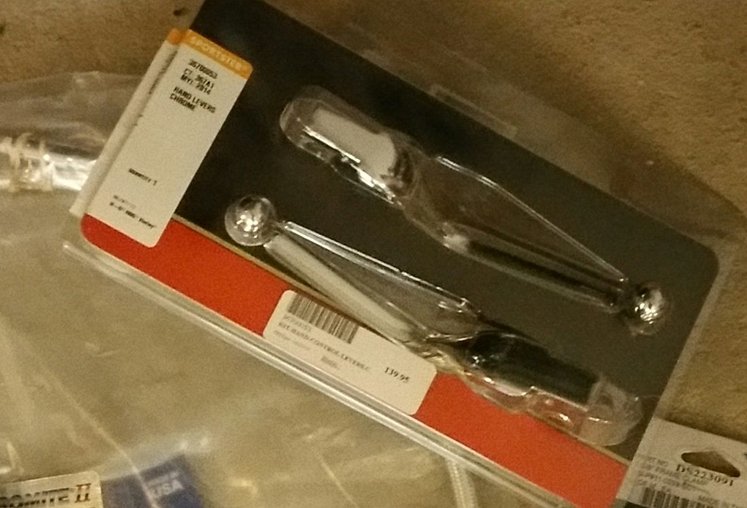

There were some changes in 2014. No idea on all of them/full list but, i can definitely say that the hand controls changed in 2014.
These dont fit my bike too small at assembly contact points:
Some parts are listed as 2003 -2013 too. Seen it a lot while looks for goodies.
