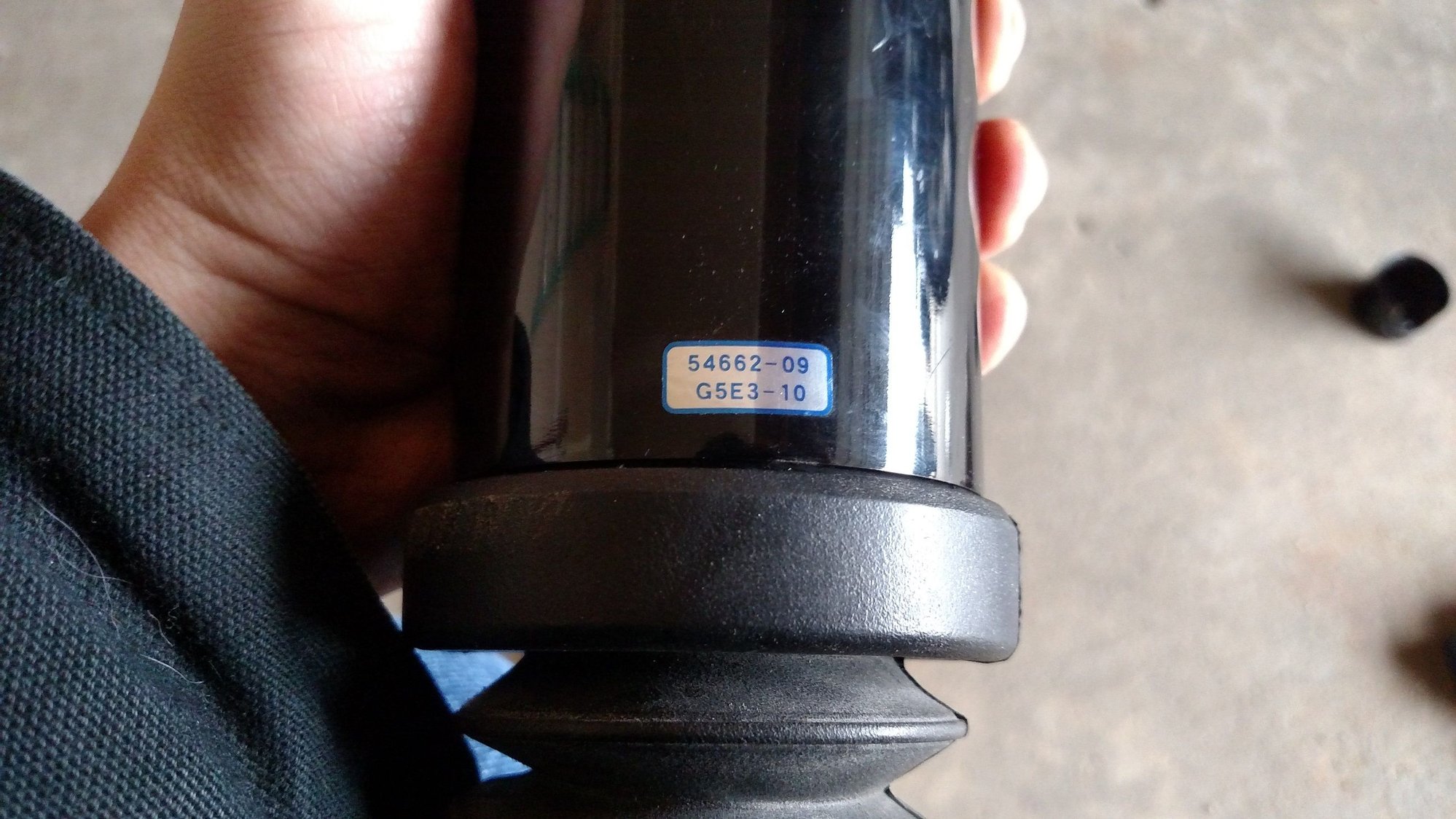

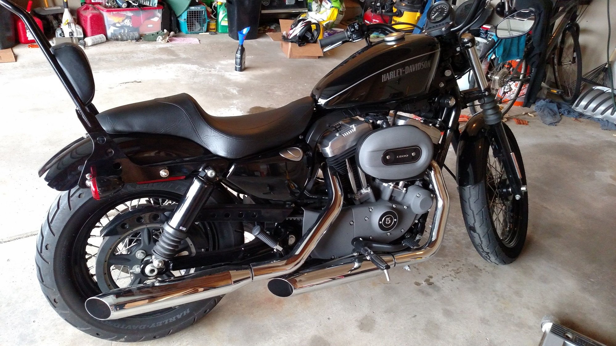

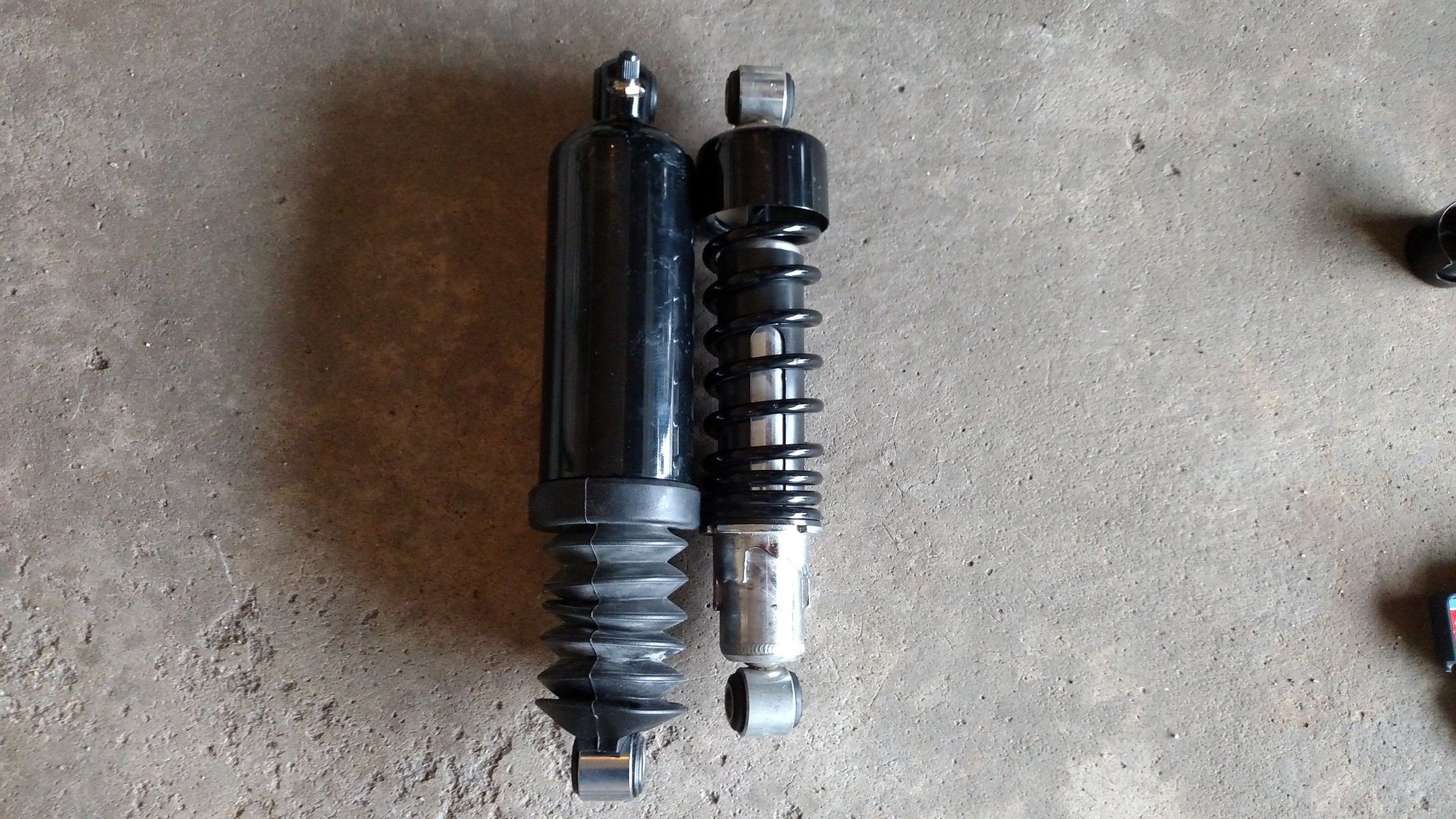

Thanks to this forum the idea of air shocks was planted into my brain. Today I finally got around to installing them on my Nightster.
Got PN 54662-09 from a street glide (I believe) off Ebay. It is night and day difference.. I don't have to tense up every time I see a large bump coming or worry about rectal bleeding anymore.
Thanks for the instructions and forums on here for the instructions on how to do this.
For anybody that does this mod in the future, definitely change the oil in the shocks prior to installing them. When I got mine, they did have plugs in them but I'm guessing most of the oil drained out before somebody put the plugs in. Because only approx 2 oz of oil, total, came out of both shocks.. They should have 10 oz each.

Looks great and I know the ride is better!

Looks great! I recently did the same to mine. Night and day difference that's for sure!

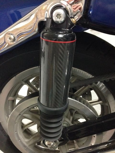

I just installed the Schrader valve on each shock and the few times I change the pressure I just use a bicycle tire pump and a pressure gauge intended for quads as they read accurately from 1-15 PSI, it's a lot less messy than installing the hoses & stuff. I run 1 PSI by myself and 5-6 PSI with a passenger.
I did find the black paint a bit plain so I wrapped mine in some "carbon fiber" vinyl and added a thin red pinstripe where the carbon fiber ends just to finish the edge, might look silly to some but I think it looks better than just plain black paint.
