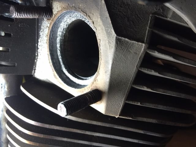

I hope someone could help me here. I have a 2013 1200C and I'm replacing the header gaskets. After removing the header pipe I see what looks like the old gasket really pressed into the head. I have two questions?
1. Do I somehow use a tool and scrape out the old gasket? Or just put the new one over the old one. See the photo, it looks really pressed in.

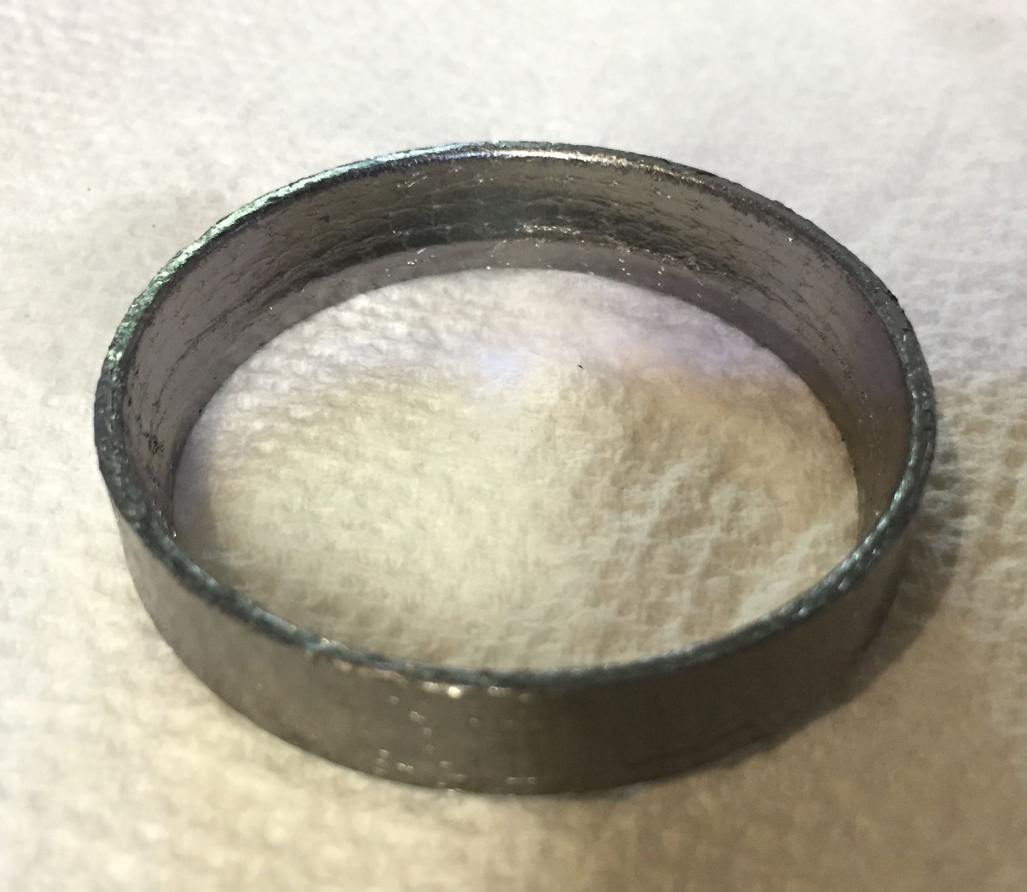

2. I put the new gasket over the header pipe just to see how it fits and to figure out which end of the gasket to put on the pipe vs the head. Well it doesn't easily fit over the header pipe. Do these stretch over the pipe so it's just a matter of forcing the new one on? See the photos. Or do you just put it in place and when the header bolts are fasted they will seat?

Does this end go to the pipe?
This end goes in the header?

Remove the old gasket..use a bent tip pick.
http://www.harborfreight.com/6-piece...set-93514.html
I used SE gaskets at the recommendation of my contacts at the dealership. They said it is a lot easier to install than the OEM gaskets. You gaskets look like OEM.

Yes, OEM. I gather using the pic to remove the old you insert the gasket into the head, then fasten the header pipe?

Yes. Here is a fixmyhog vid that that will show you how to remove the old and how to install the new...and shows the difference between OEM and SE.

I recently refitted my exhaust. I used a thin screwdriver to remove the old gaskets from the heads, then carefully installed the new ones, same as yours, in the head first, then gently centred the pipe in it before fastening the exhaust nuts. This is one of those jobs that looks a bit daunting at first, but with care is actually a lot easier than it first seems.
I don't recall where, but on HDF recently there was a thread recommending using a little grease on the gasket, to aid installation. I read that shortly after I had finished my install! Next time.....
