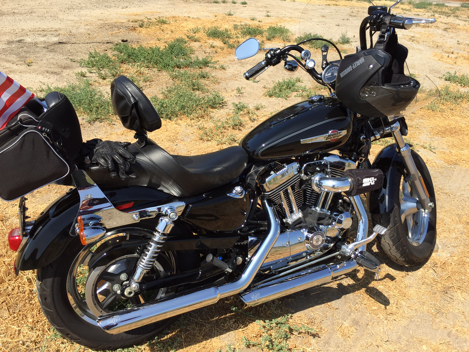

These bars are so much more comfortable, it's a huge difference. Before after just a 2 hour ride I was exhausted. I rode for about two hours and got back and felt like I was ready to go again. Control of the bike is easier with these. Too bad the stock bars weren't like this because I still think they look better on the bike. Here's an updated picture with all the other stuff put back on.
A guy on a larger Harley asked me if my bike was a wide glide, huh - told him it was a Sportster.
