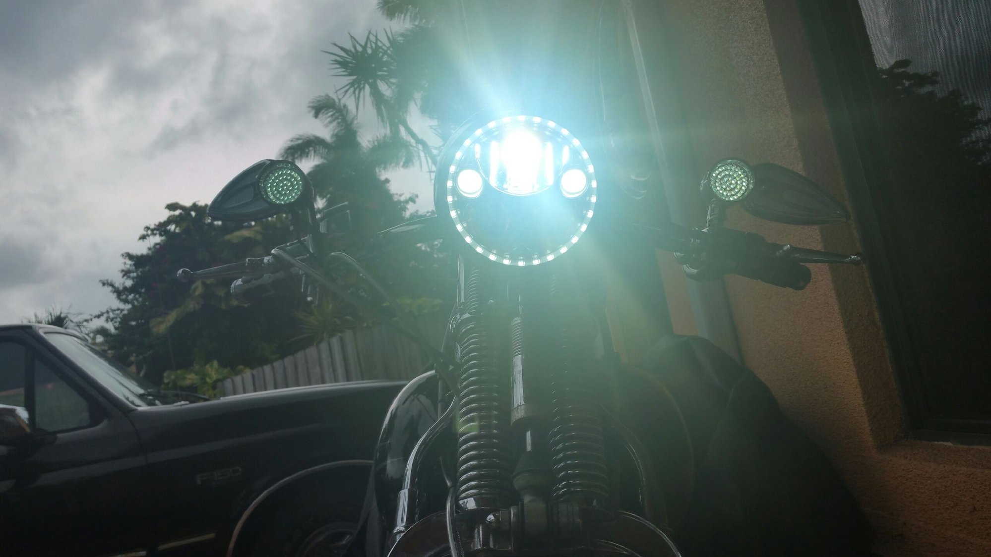

Hey! I started this thread and still have no solution. I tried the Sunpii and it didn't fit. Has anyone, else had a fitment problem? My bike is an '07 Sportster 883xl. The one I bought was a 5.75" but it was too big for the opening.

not to be rude but, you got your answer... "stop, no, and don't. " there are a million of these led/headlight threads... the hd daymaker is always a fail in the price to performance arena, it is flatout a bad buy, no question about it. it's just a rebranded old style j.w. speaker evo that can be had for about 250.

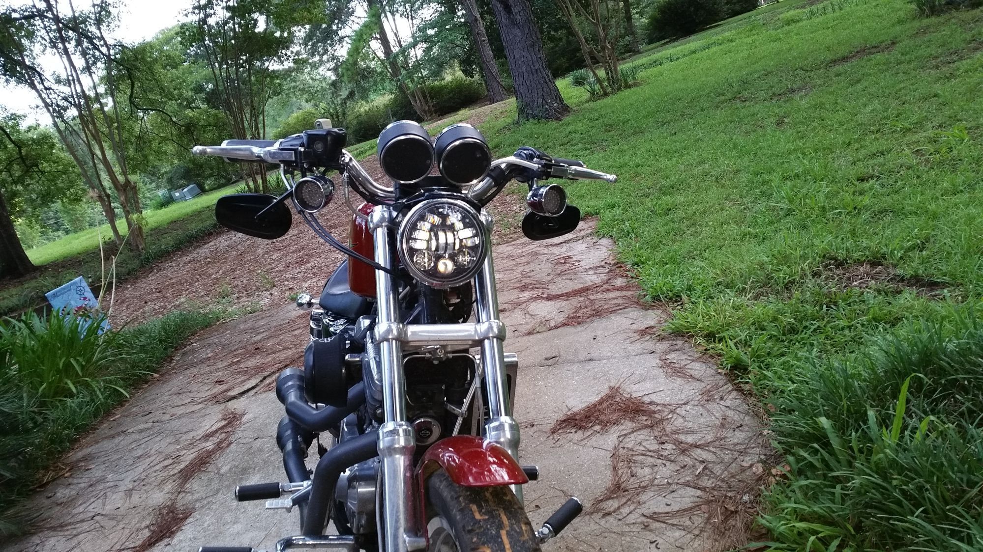

a 5 3/4 will fit your bike if the housing is unmolested and the led is not a led made for jeeps and old cars. i have an 07 883xlcn(standard) and 5 3/4 fits just fine. getting it to seat is a matter of cable management sometimes. take a picture of the rear of the unit it you got hold of and post it.
on the high range (400 and down) the 8690M, truck lite, and trubeam are where you want to put your money. on the low end, an h4 led or knock off...
or a plain old beast halogen like the osram night breaker, hd high performance, sylvania silver star, etc. there are quite a few in the middle worth a look...
my 5 3/4 8690A in stock 2007 housing.
