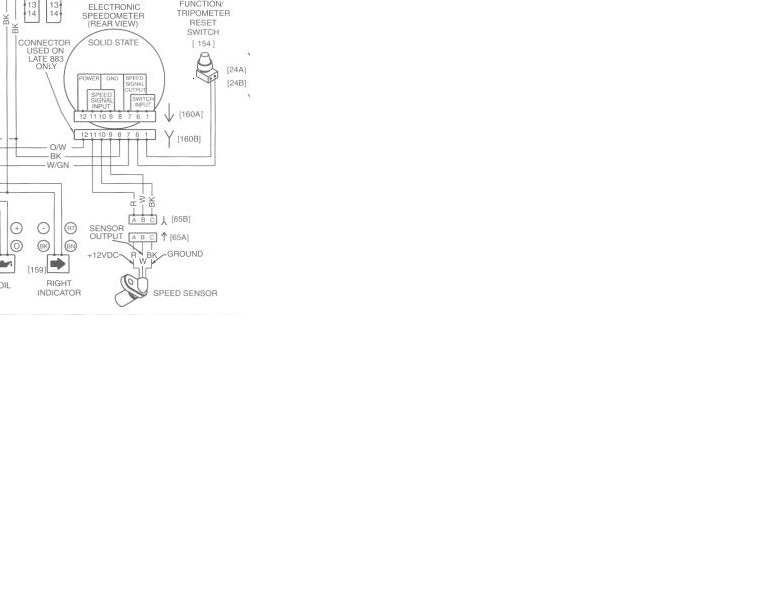

So in looking into this further, I see where the speed sensor wore runs up under the seat and the plug is laying there not plugged into anything? Should the other end of the plug be right there under the seat? I tried tracing the main harness from the front of the bike / speedo area but can't find the other end of the plug or any cut wired where the plug may have been.
How can I find the plug or wire and how could I wire the speedometer to that end of the plug on the sensor to get the speedometer working again?

I don't intend to be a smart ***, but can you get a SM with the wiring diagram? It'll save you a bunch of headaches, money and wasted time.

Try tracing wires from the speedometer back toward the VSS connector.

It should be right their,unless some one else removed it.

It should be up under the seat kind of near the left frame rail, a little triangular gray plug if I remember right.
