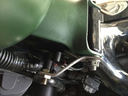

I went with Progressive 430's Standard Springs. I wanted a shorter seat height so I got 11". The 430's are hand adjustable so I can adjust on the fly depending on the ride. I'm 5'8" tall and 175lbs. I installed a solo spring seat so I sit higher than the on the frame seats to begin with.
I don't bottom out but it's a stiffer ride which I don't mind. I'm choosing form over function in this instance.
If I ever change I'm going with some sort of air shock as they seem to give the best of both worlds.
