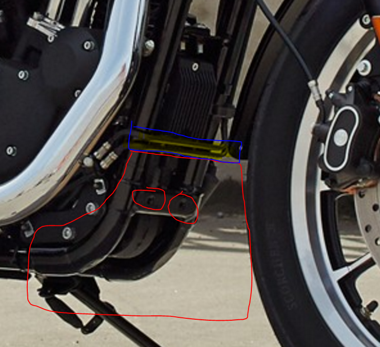

2. review the facts...
blue=abs area
red=fairing area
the fairing connects to the vacant bolt holes on the front of your frame (will take some "persuasion ")
there is no interference with abs... the abs module sits in the rear
abs module
and there is space between the regulator and the chin fairing mounting area for the lines running from the tee on the forks.
people just say silly stuff without research, just to say stuff. fk'um
your fairing will bolt up just fine. no worries.. get the cheapo and be happy. mine is still going strong

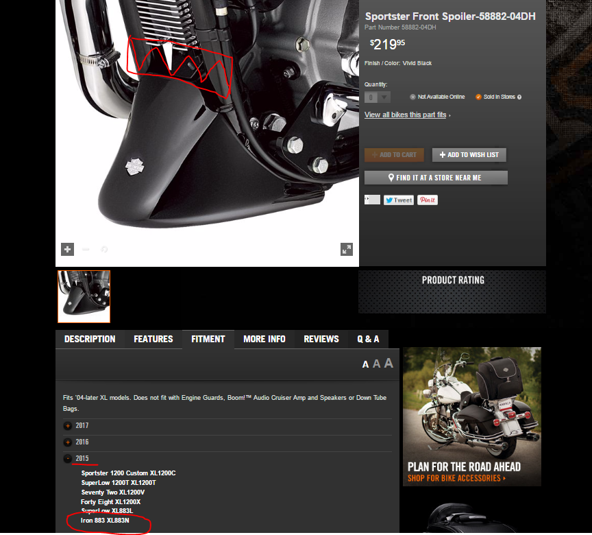

harley supports me here:
