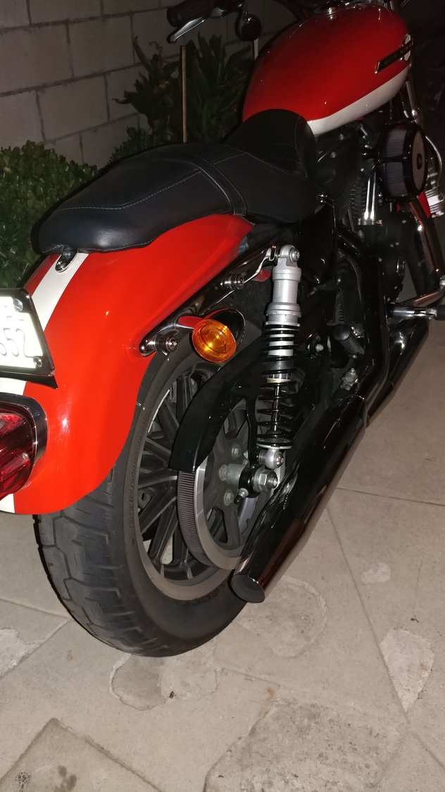

Default Ohlins 916E
Got 916E's, 13.2" on my '08 1200R. No jiffy stand issues. Well worth the coin.
