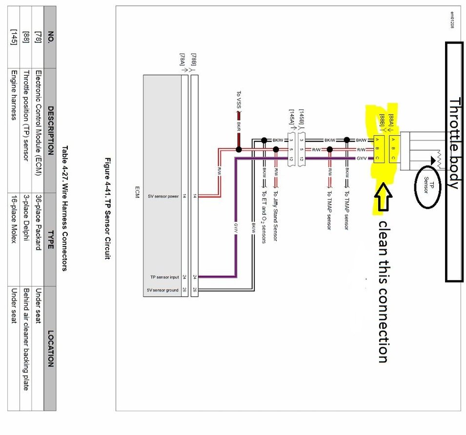

Originally Posted by Matthew Valinsky
I have a 09 iron 833. And my engine light came on with the code of p0122 for the throttle position sensor. I buy a new one install it and the light goes off. I leave it on for about 5 min than the code and the light comes back on. Did I do something wrong skip a step? What can I do to fix it. Thanks
clean your throttle body and adjust/lube your throttle/idle cables. did you clean your TPS connections with e.contact cleaner?

the terminal(wire end) you plugged your TPS into (again, likely not the cause) and your throttle body... behind your air cleaner.
the part may not have been bad, just dirt/oil and build up in the throttle body, causing the sensor to throw bad readings. i'm pretty sure you didn't install the TPS incorrectly, that would take some serious effort to mess up.

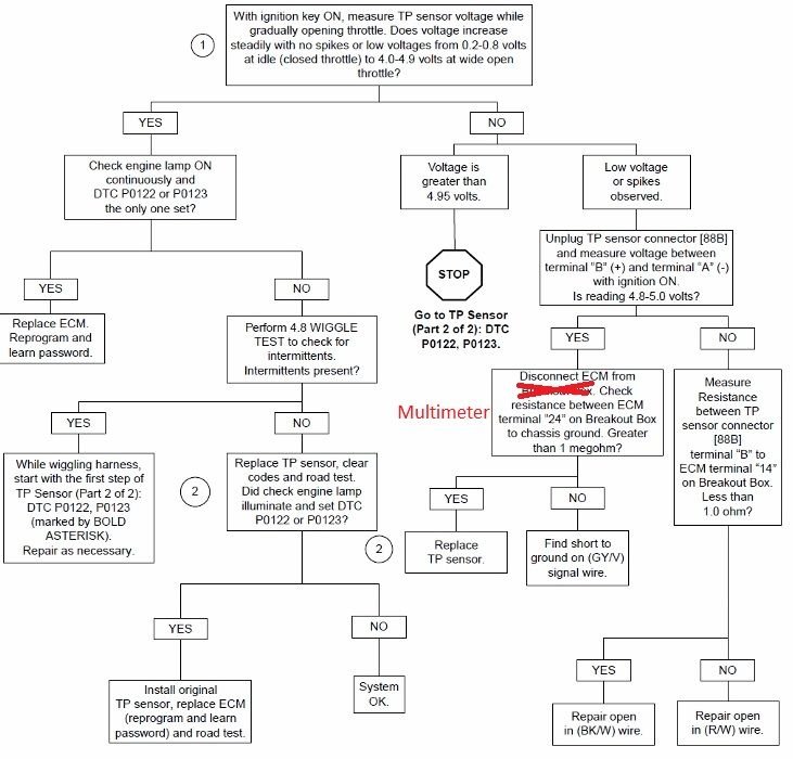

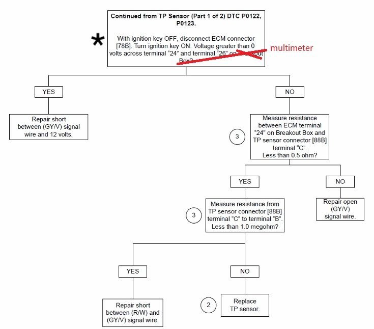

throttle body cleaner and a tooth brush
you will not find that above or this stuff below in the service manual:
wiggle test, lol

Okay so where exactly should I connect the multimeter to check ?
