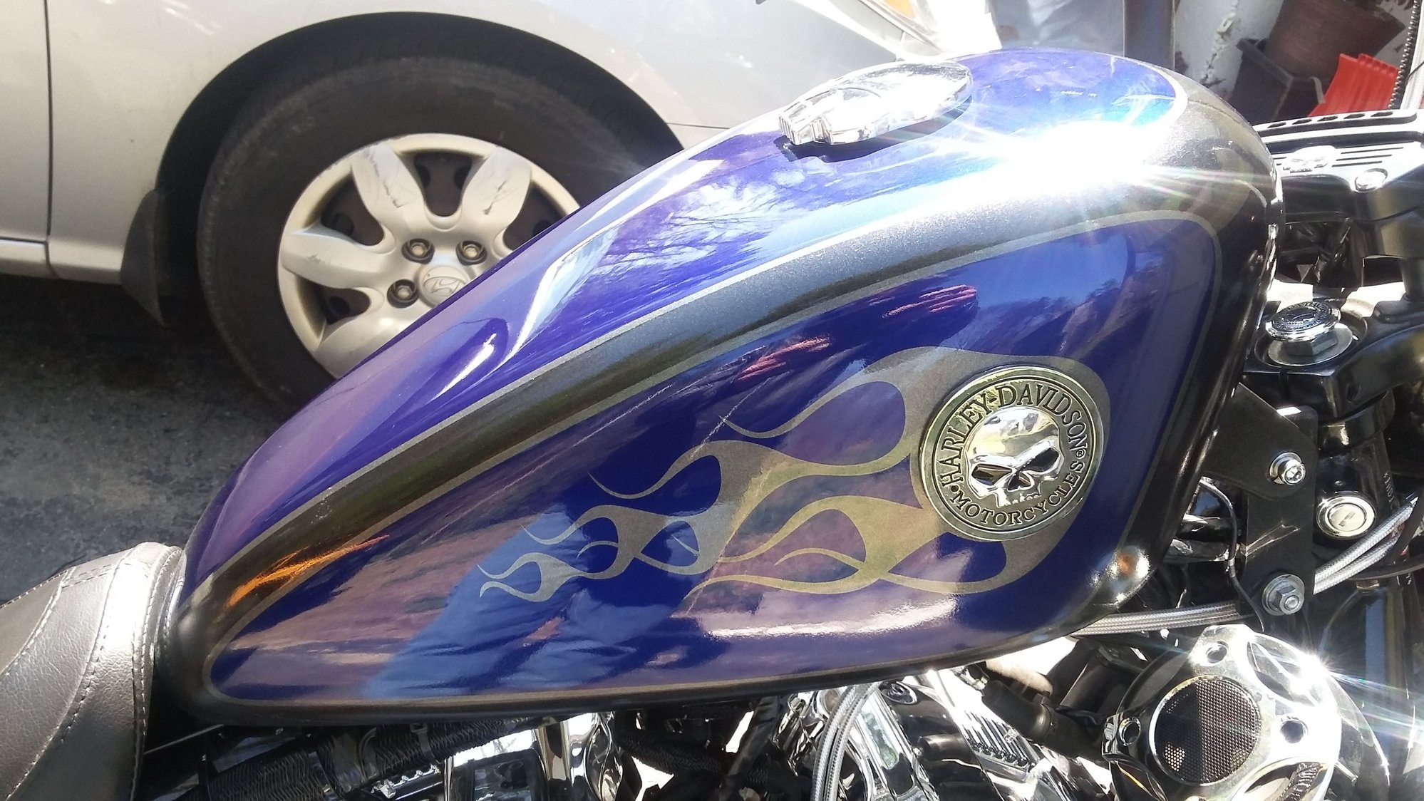

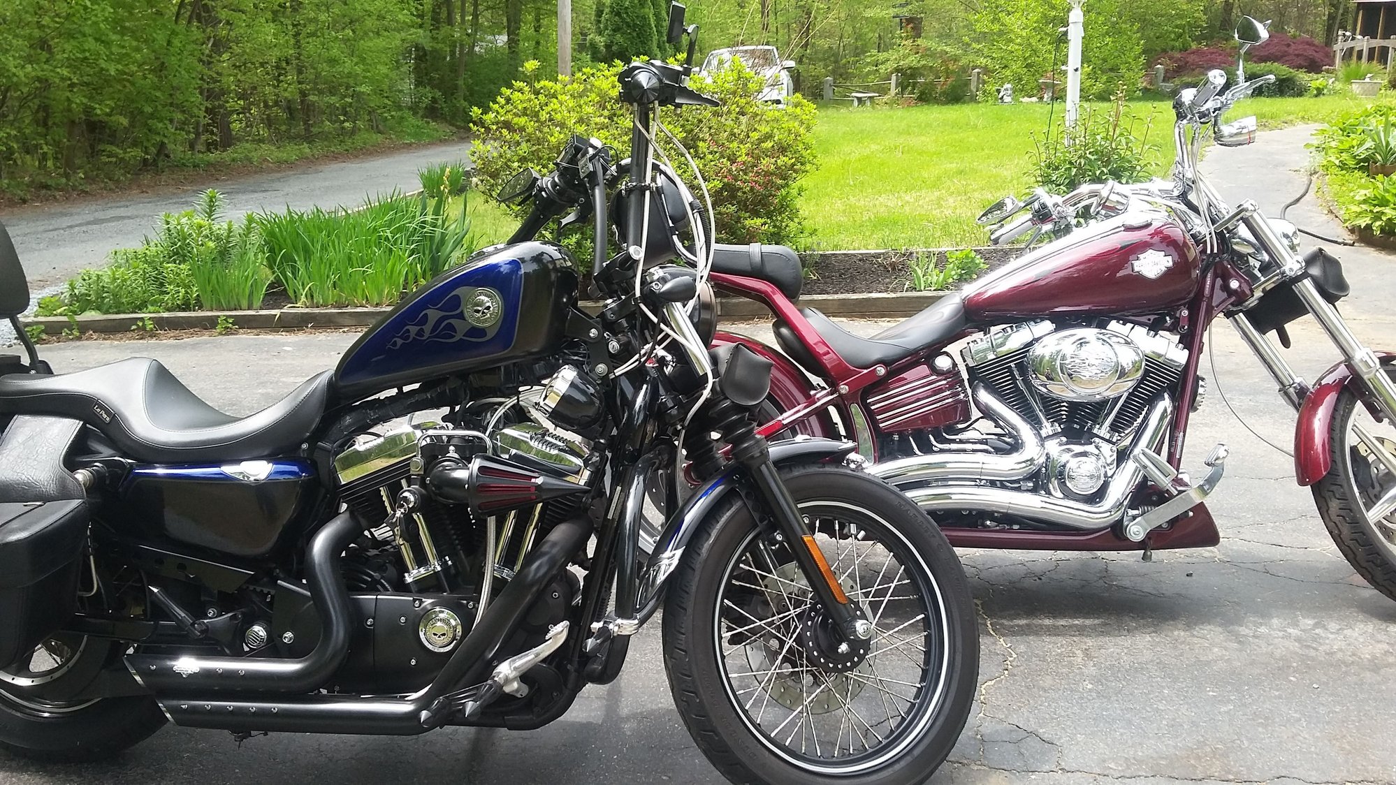

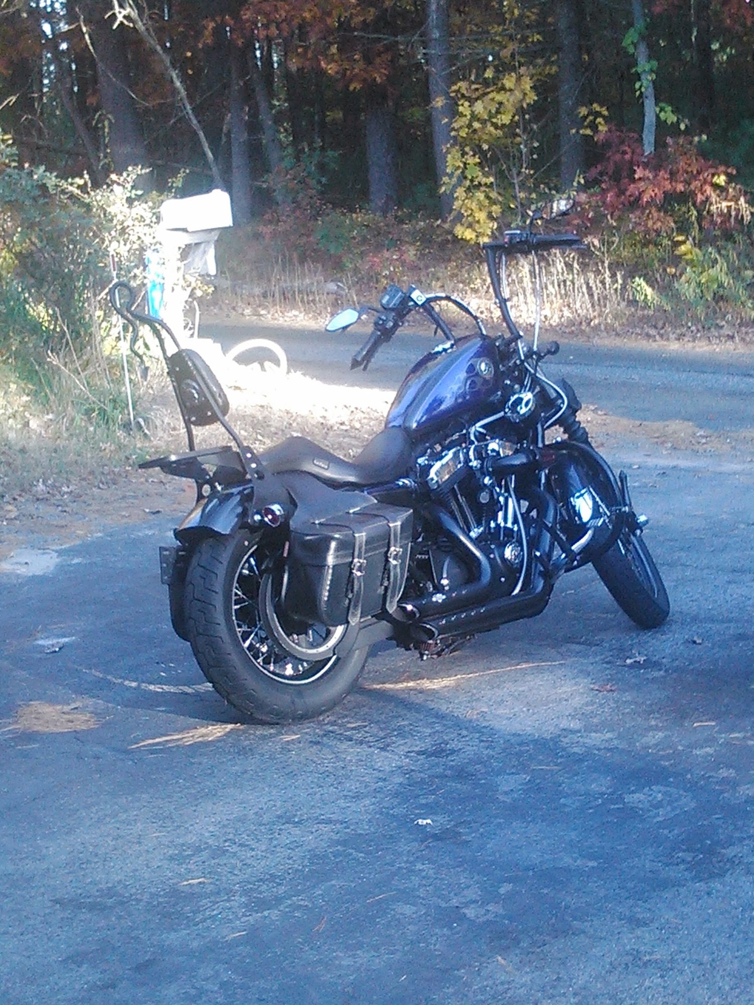

I would advise against clear coating over a decal oracle651 10yr outside vinyl doesn't react well with urethane based paints or clear due to the type of adhesive . Oracle 631 wall vinyl is a interior decal is better suited to your needs however has very limited durability in outside applications. I suggest using it as a decal without the clear or as a stencil and painting it on. I've done this already last summer search my posts if interested. Also if your interested on my pintrest page I have a hundred or so vinyl stencils for sports term tanks if interested I'll get you a link.
