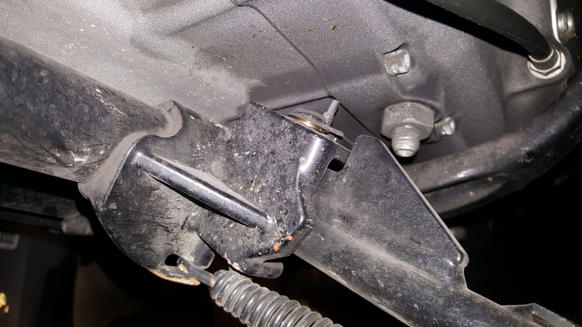

Went out in the garage and crawled under mine and took this if it helps.
Looks like your upper bushing needs a bit of attention!
Hmmmm. Yours looks different than mine. Mine even looks different than the pick in the manual.
yea saw that... Thanks.
Did a bit of off roading, you can see the rock rash.
Yea brotha! Same. Not a dirt road I won't travel down. Just did my bushings. But mine was actually dangling and flopping in the breeze. There was nothing left of them. As a result, it was hard keeping over center. This problem seems odd.
I was figuring model year difference... Sorry I can't be more help.
But your post caused me to find an action item on mine, so thanks for that!
