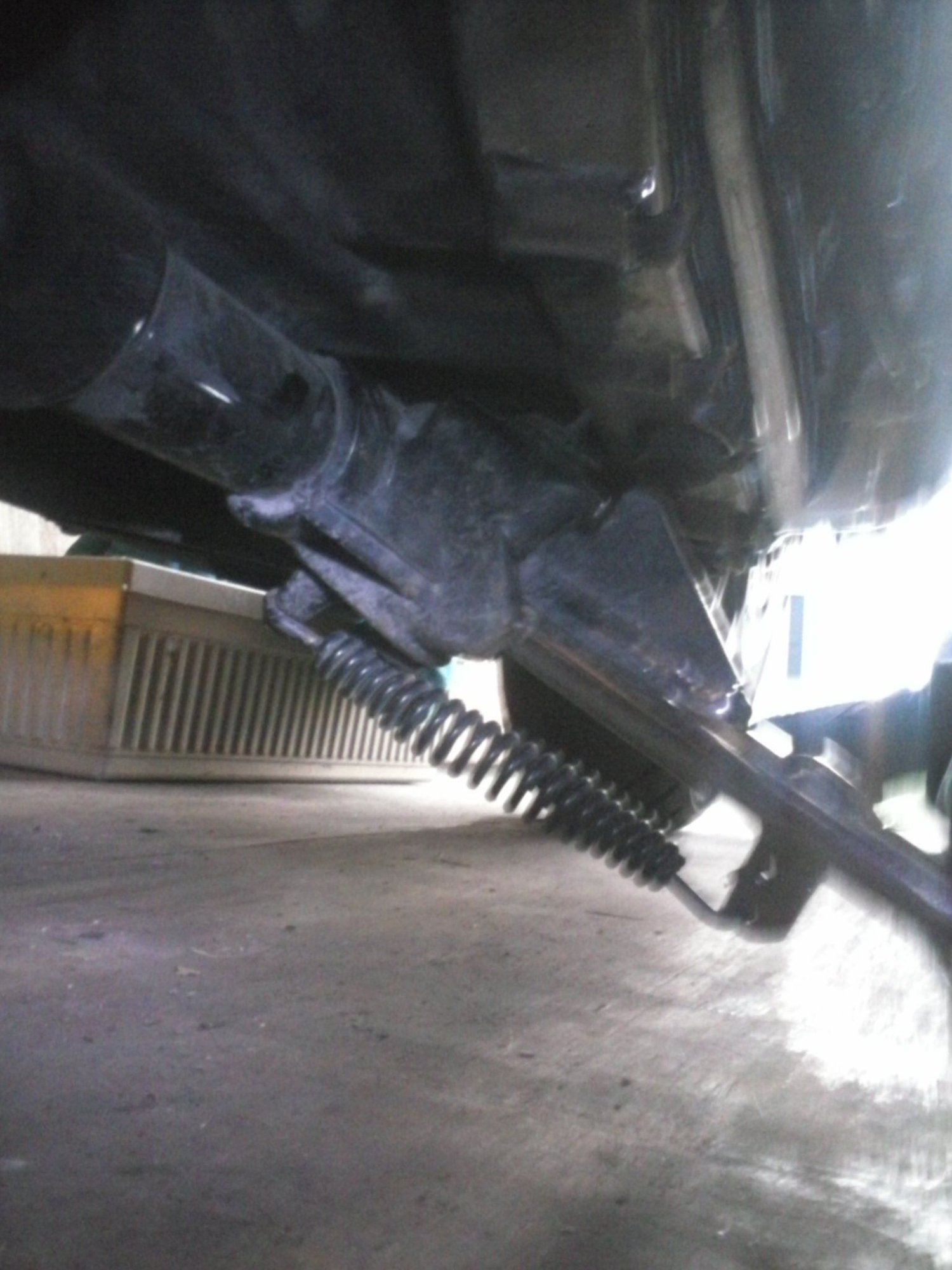

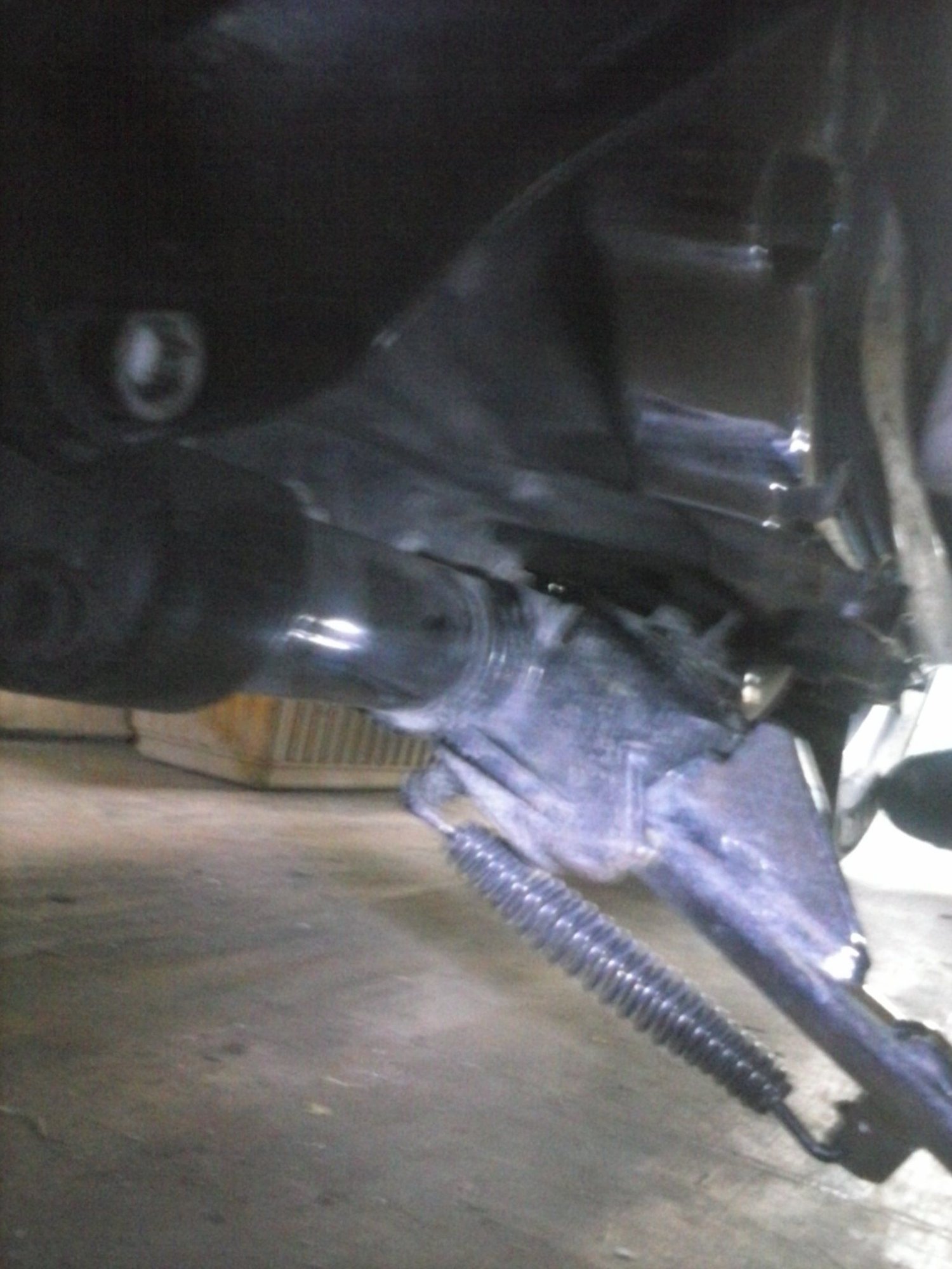

My jiffy stand on my 08 XL1200C only locks in place with the bikes weight on it. I checked it out and it appears that is how its supposed to be. The manual says "The vehicle is equipped with a jiffy stand (or side stand) that locks when placed in the full forward position (down) with the full weight of the vehicle resting on it." I almost dumped it twice because of this. I can't believe it was designed like this. I saw different fixes for other models but not for sportsters. Is this right? And if so does anyone know of a fix? And hhow do I make my pic smaller?

Make sure the spring is on correctly as I am sure you did, but if it is on backwards, it may be the issue as well. How about a big closeup of your current setup! I like big pics. The old eyes ain't what they used to be.
