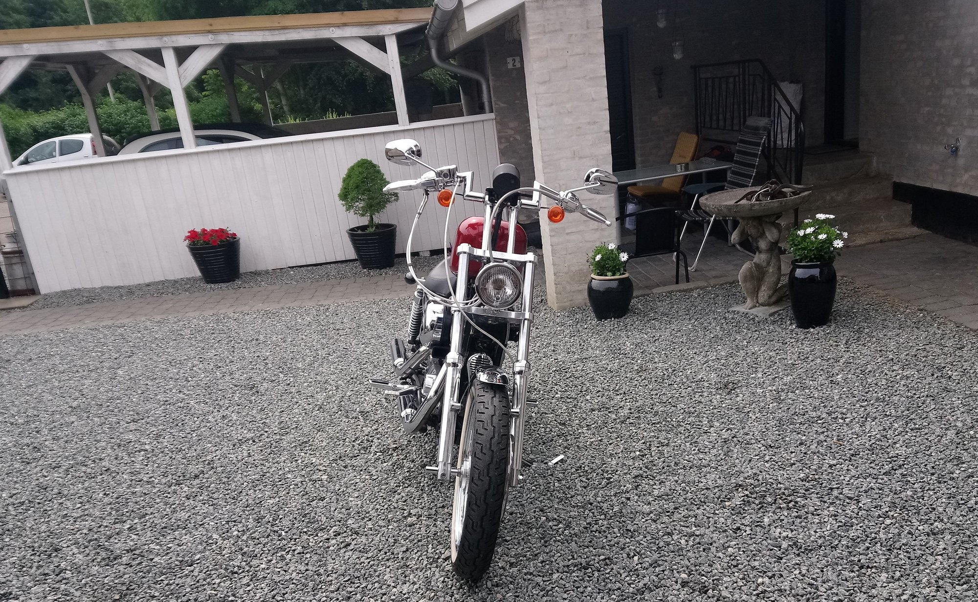

my new buddy Jan has this 2005/2006 sportster 883 iam helping him modifying it over the vinter.
with a newer style rear fender aftermarket tank and used front fender, plus wide glide front end and forward control´s (but we can only reg max 3 thinks and 1 each year so front end is now and the forwards will go on after reg. this spring. he got 8" riser cause they where 25% off what the 10" so that may change again, paint is candy red with flake and maybe a 2 tone on the tank, oh and he is looking for used fat bob crom dampers for the rear
http://www.thebikerstore.eu/product_...7-0--rake.html
http://www.thebikerstore.eu/product_...ter-04-06.html
http://www.thebikerstore.eu/product_...om-lenker.html
he bought my rear light´s from my iron, and the asked iff i would help fit them, and new front turn i mirrors just eletricks he he well let´s just say i took it apart and he helped, but having fun spending his cash he he
worked on it from 10 am to 3 pm 1 hour lunch in between

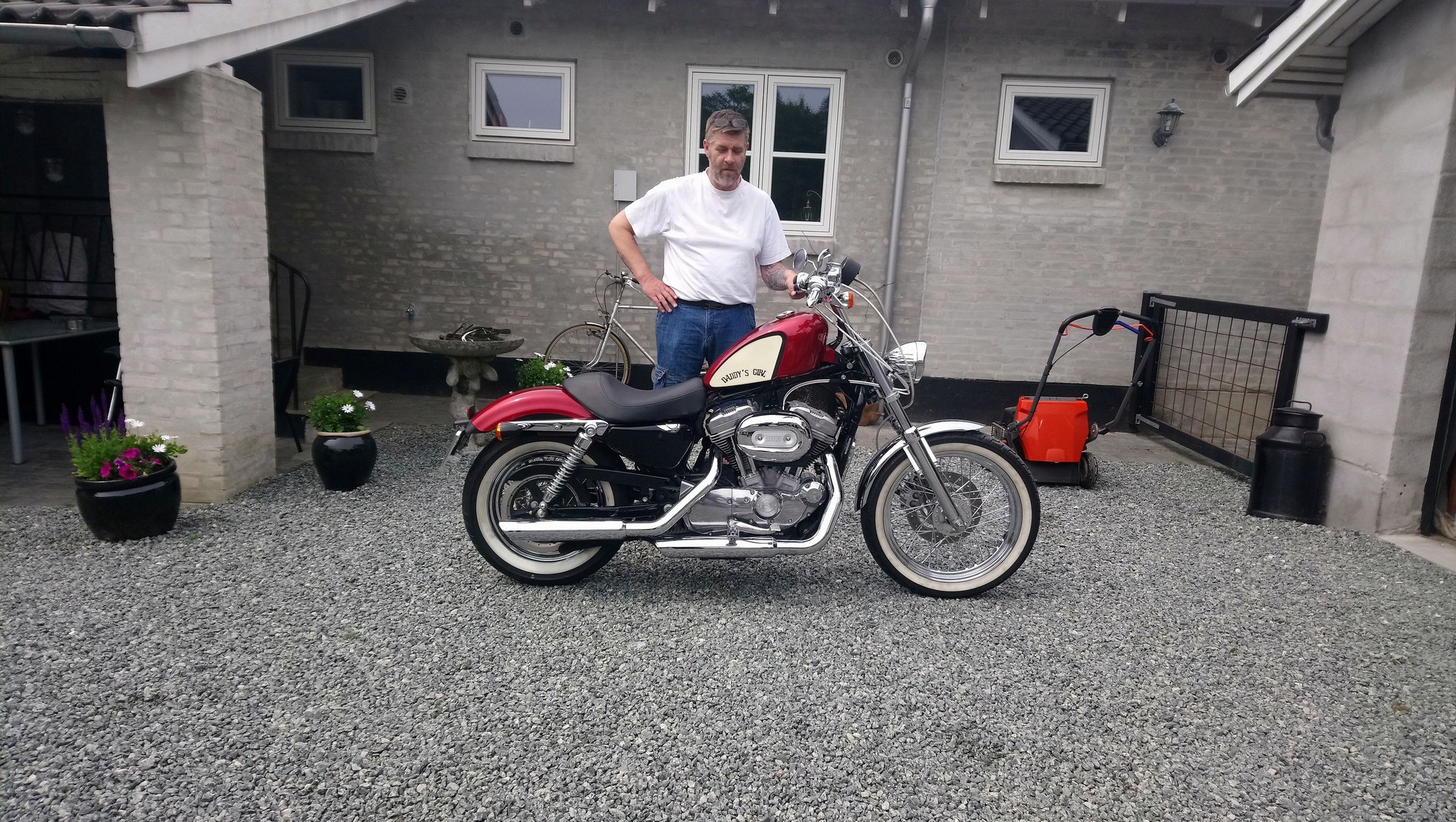

so a little update got the headlight loom finished and tested tried the front wheel not good we shorted the axel cause we did not know what was what, and no fitting instructions, shorted a few bolts for head light, trippeltree stop and bars, the painter was finisch last week but last buff got it scratched so he will pick it up tomorrow.
1 step forward 2 steps back he he
regards
Sören

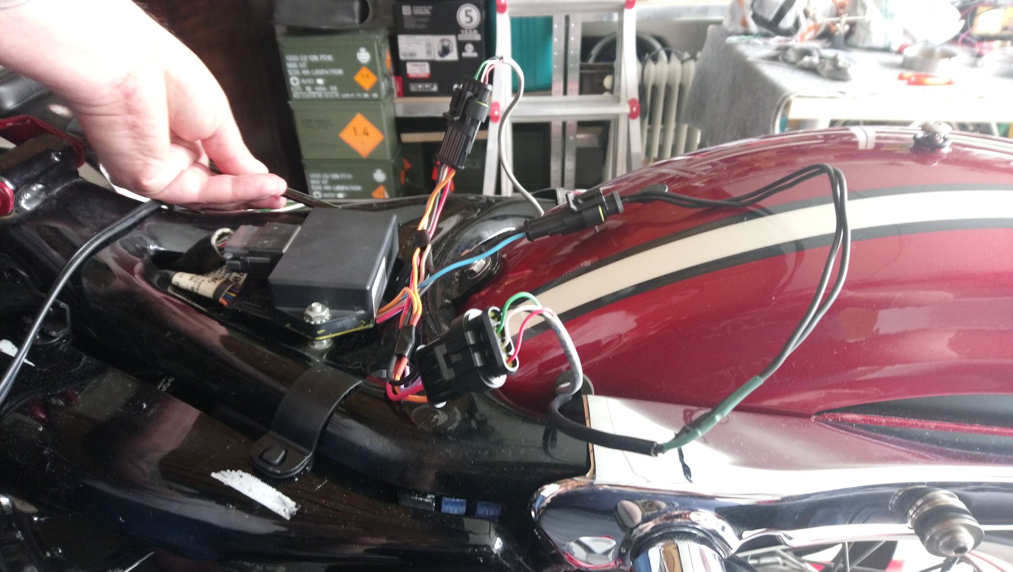

From: denmark

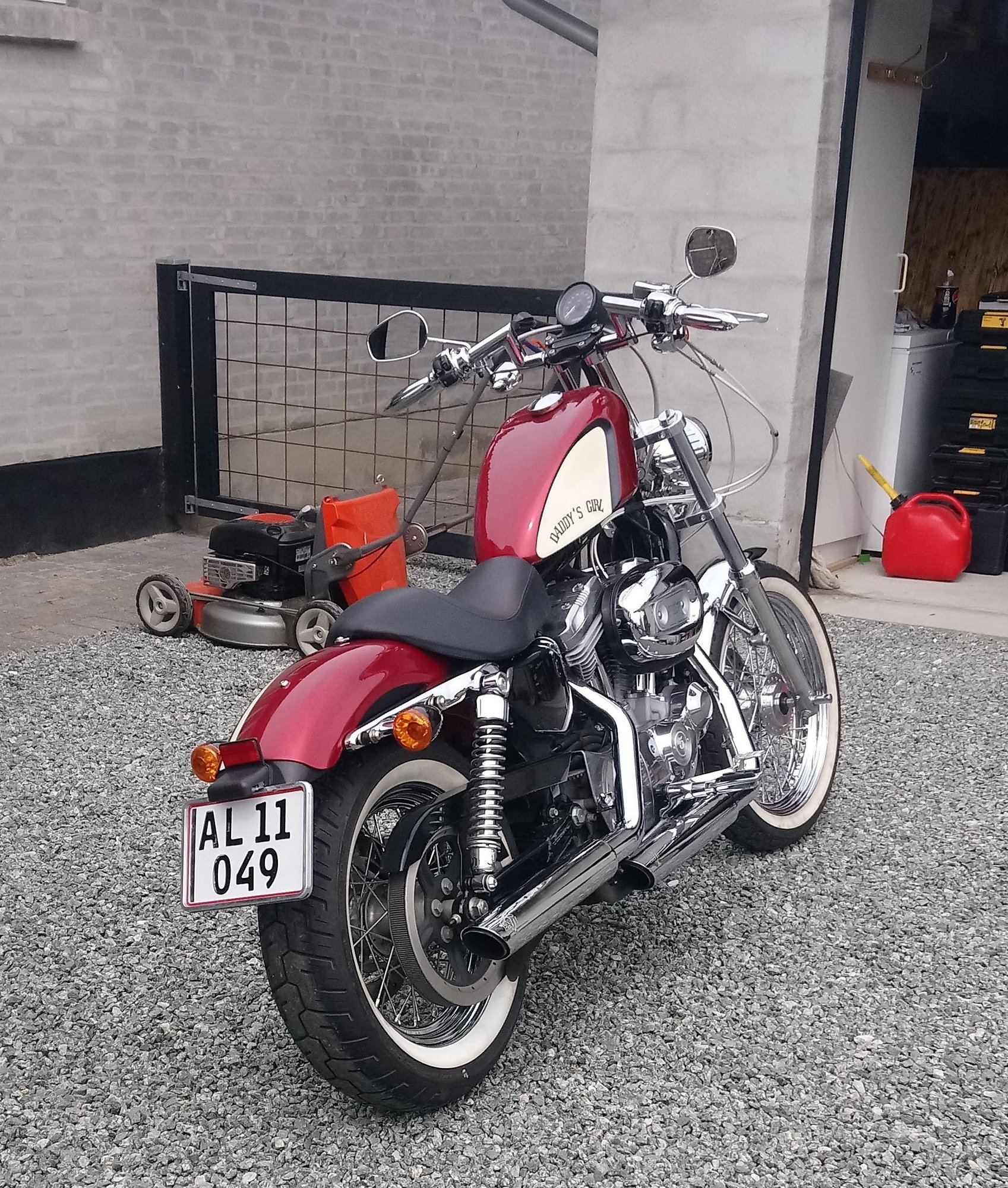

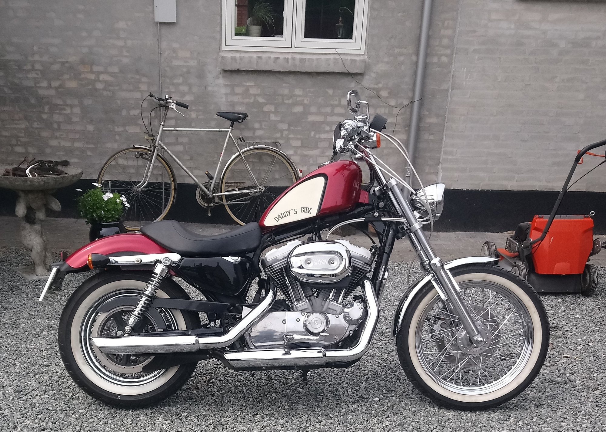

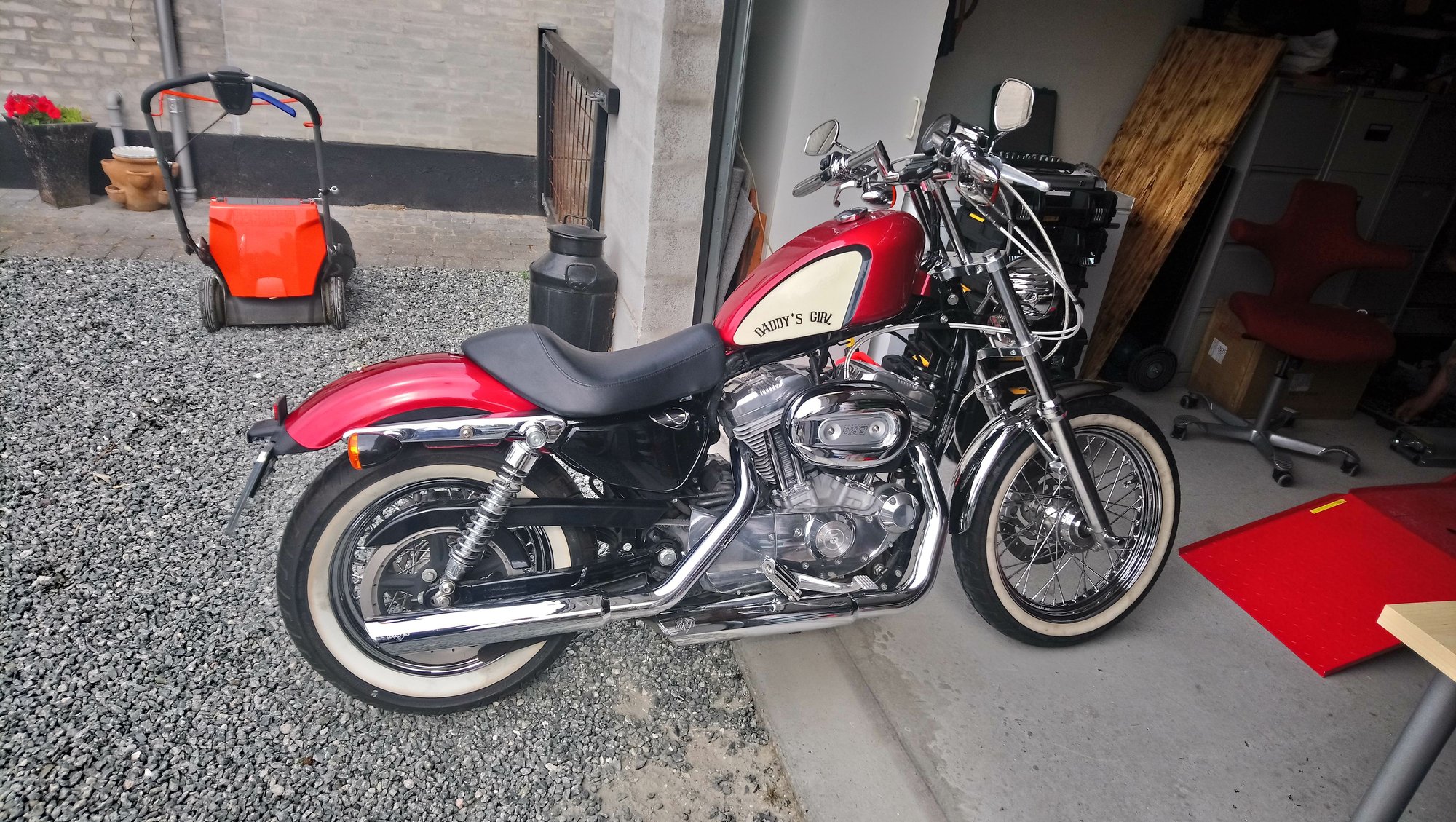

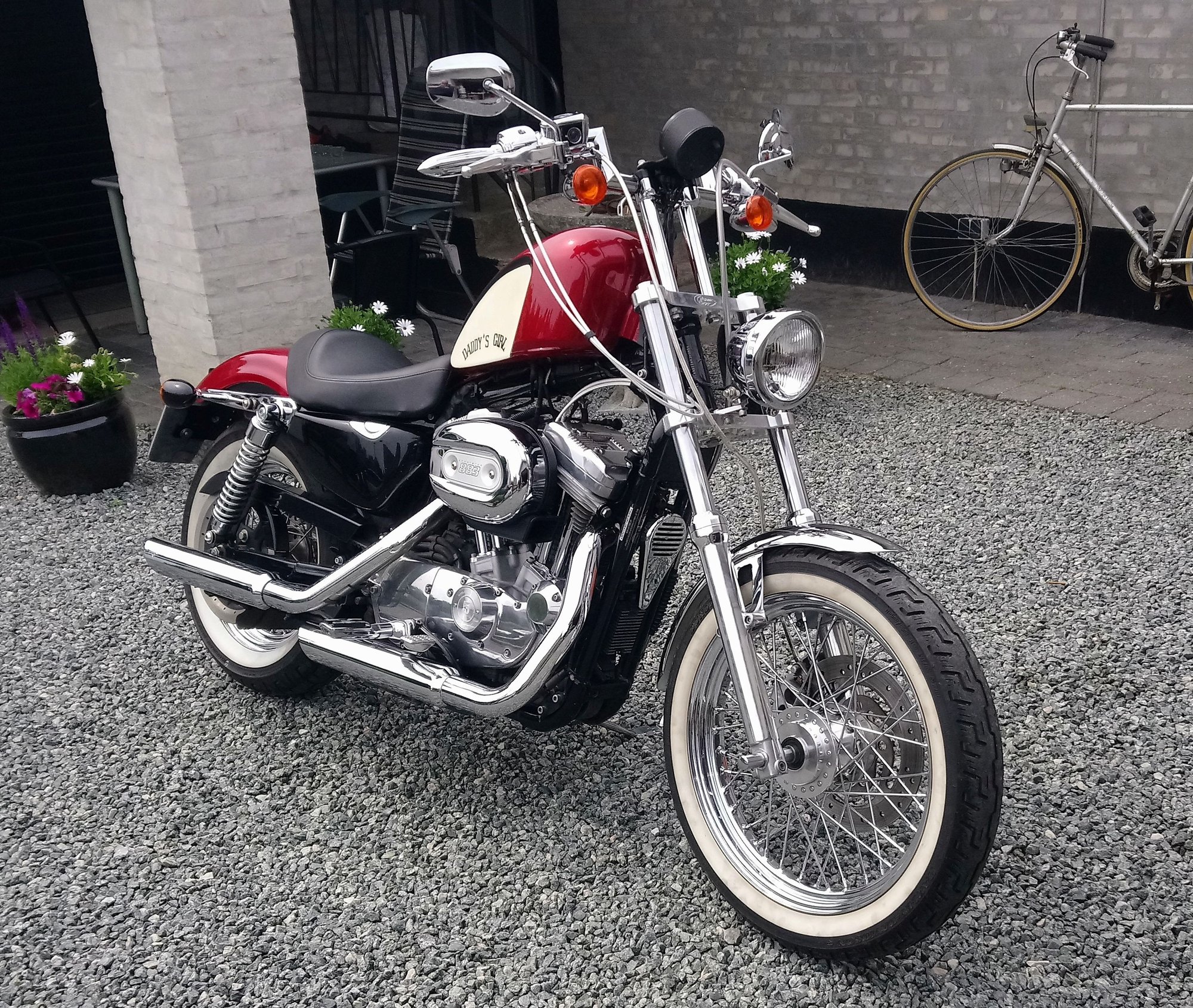

today i put the wires in the housing and tested the light´s only the front brake had i little problem it could not reach the switch so the brake light was on all the time,but put few washers in to push it out(switchhousing is for 2003 and older(he got the wrong one´s but made them work) he just needs to do a full service and tight the last bit´s and bob´s like the trippel trees on the frame neck.
i have problems loading more pictures off the bike the new system is not as good as the old one
