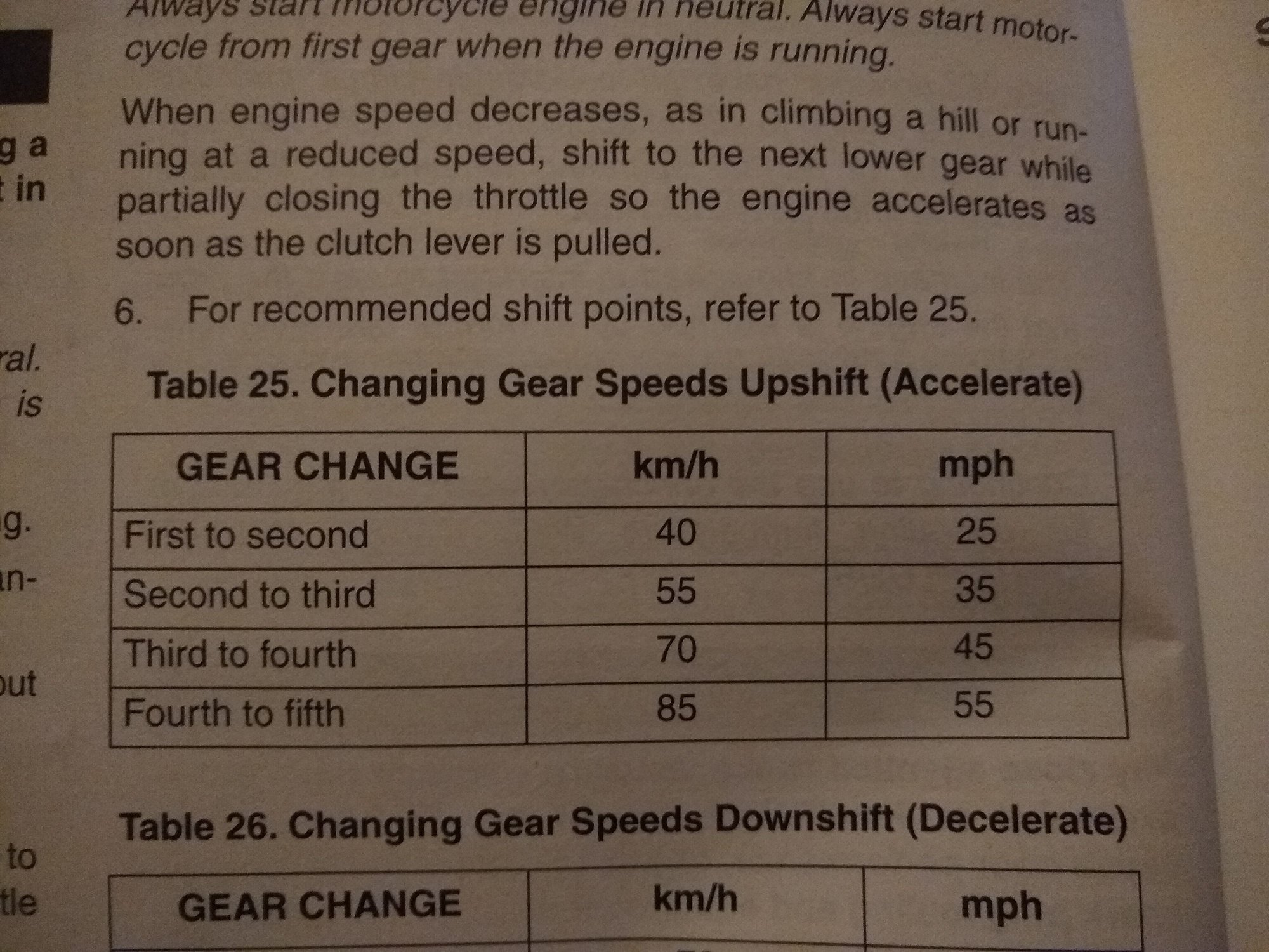

I'm not suggesting that anyone has to do things by the book but here's the book .

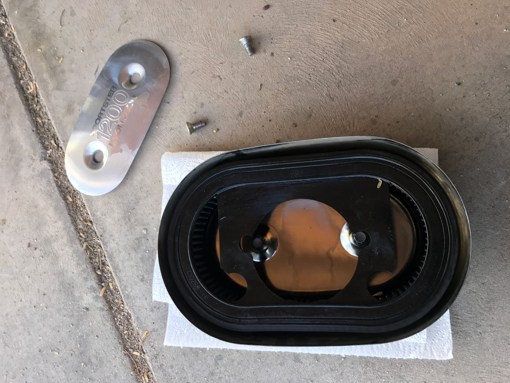

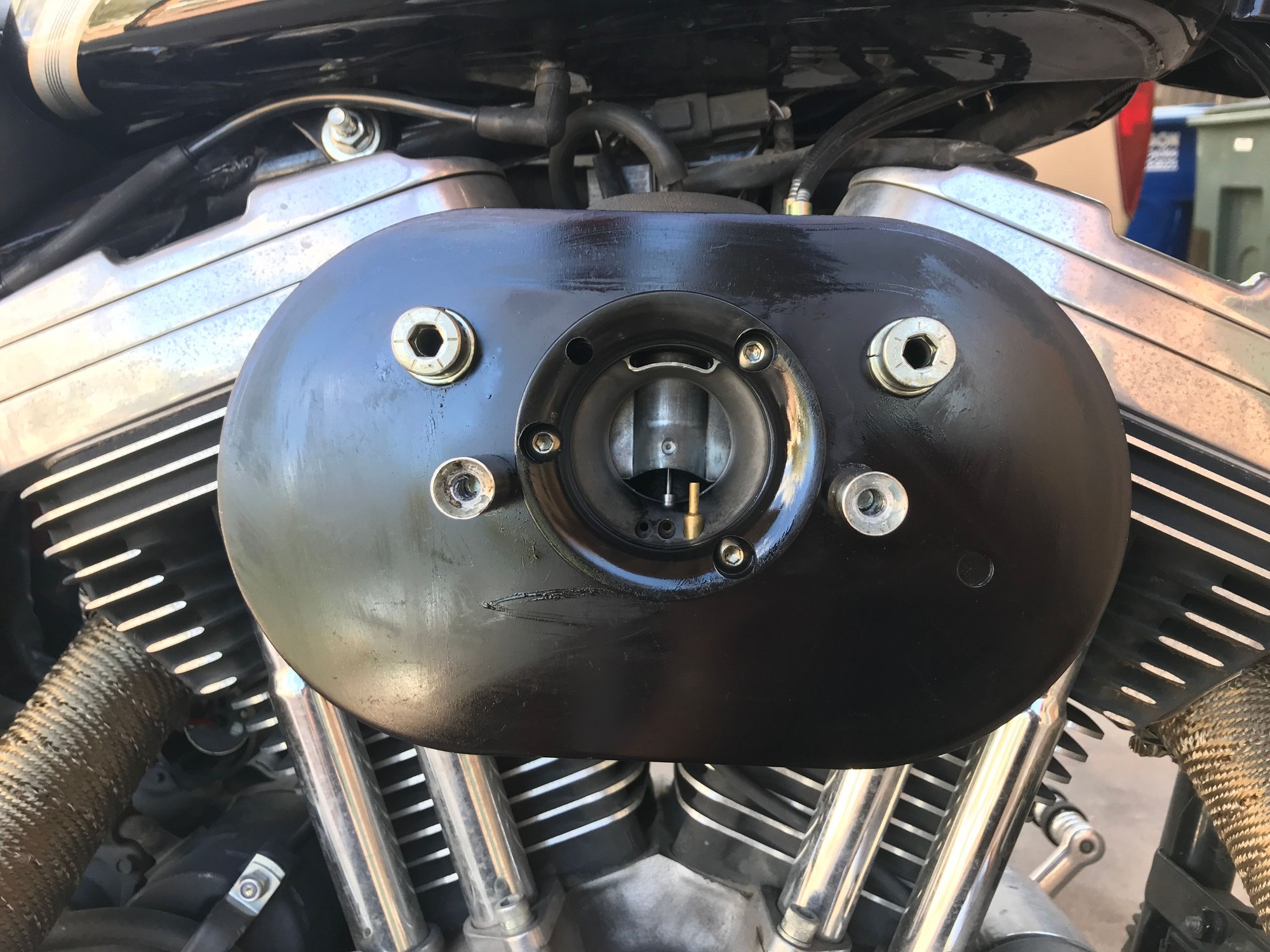

Originally Posted by Midpegs
45 pilot 180 main is pretty much the standard setup for V&H pipes and free breathing filter . Have you got the SE back plate and bigger filter or just a K&N in a stock air box ? I've just discovered that I've got a SE setup on mine . ( See Air Filter Question thread )
This is what I have:
I don't know what backplate this is...
K&N filter, stock box.

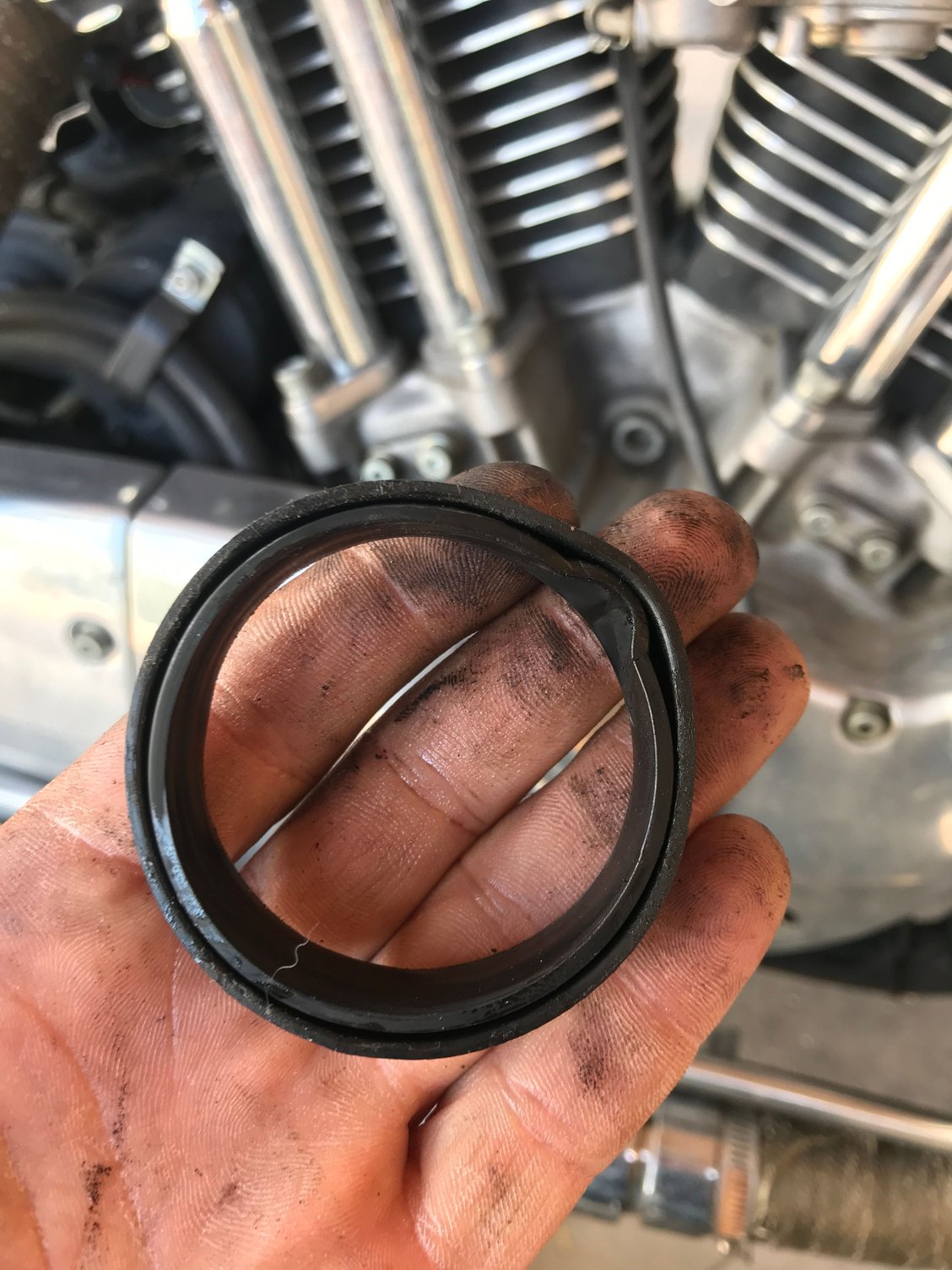

Additionally, I found this:
After replacing, she already runs a million times better. Completely different machine, not having an intake leak now! It's like night and day.
All decel popping is gone. I expect to see better mpg. Runs much smoother and quieter.
Will update soon...
50 mph in first ? That sounds like a pretty aggressive riding style . Why do you need to bounce the rev limiter at all ? I'm not a slow rider but I've never been close to the rev limiter . In fact , it's news to me that a Sportster actually has one . My engine "Tells" me when to change up without me ever having to look at the tachometer . ( 04 XL 1200 Roadster ) If you're doing 50 in first what do you do with the other four gears may I ask ?
Those are "Recomended" shift points. I'm talking Maximum shift points.
I'm accelerating hard pulling onto interstates where traffic is flowing at 75 MPH and the idiots in front of me merging are only going 40 MPH. I'm enjoying just rolling on the throttle and getting up to speed as quick as I can.
If you have never hit the rev limiter on a Sportster you need to live a little more and learn how to get on the throttle.
