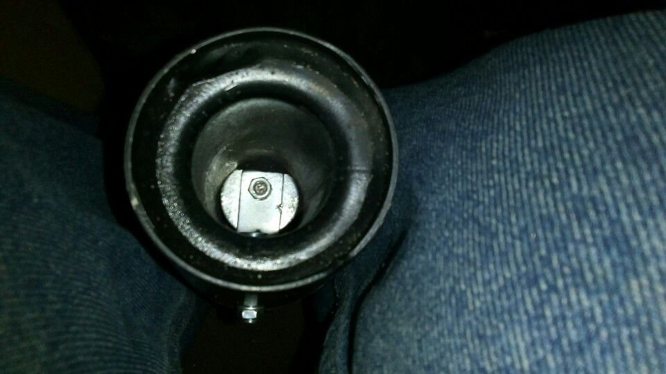

Just use a cutting wheel and cut all the way around the muffler about 2.5" or 3" from the end of the pipe and the entire baffle and cat will pull right out. Then install some TTI's and your good to go. Sweet sound and performance for 30 bucks and a couple hours of your time. Just watch out for the fiberglass baffle wrap. That crap gets everywhere!
Looking in from the rear of the slip-on at the baffle plug.
